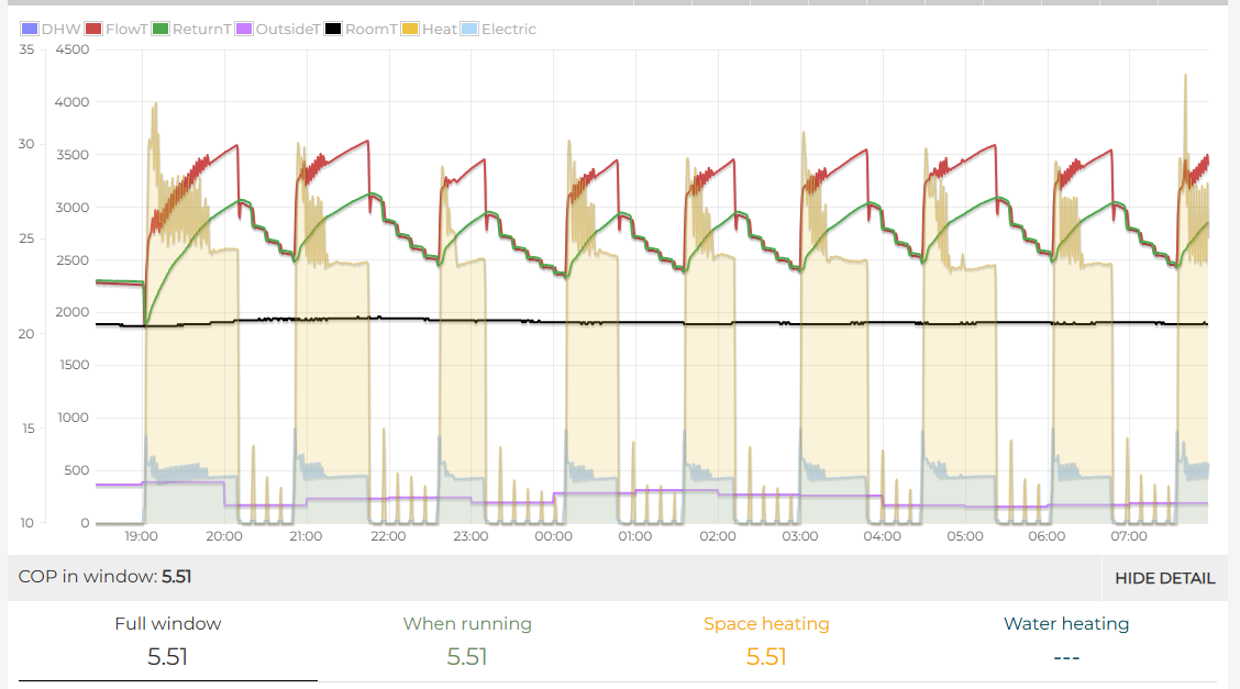

Type 1 cycling modulation. where the room temperature control algorithm turns the heat pump ON for say an hour and OFF for an hour in mild weather - this is not ideal so I reduce the flow temperature as that is more efficient.

Yes it’s fine, it sounds like you have tuned the weather compensation or flow temperature setting as much as possible. You are hitting the minimum modulation of the compressor and so at that point the system needs to cycle to provide lower average heat output.

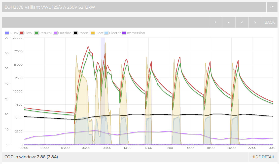

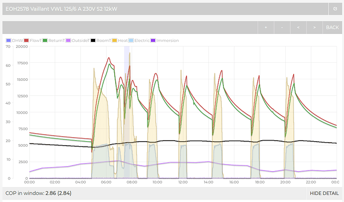

Your type 1 cycling, I call it “cycling on room temp when the weather compensation curve is set too high” is where most people loose efficiency today. This Electrification of heat example is an exhibit A of this much less than optimal cycling, a lower weather compensation setting (lower flow temperatures) resulting in longer on periods would deliver much better results than the COP of 2.8 seen here, this is discussed in more detail here Analysis of Electrification of Heat trial data — OpenEnergyMonitor 0.0.1 documentation

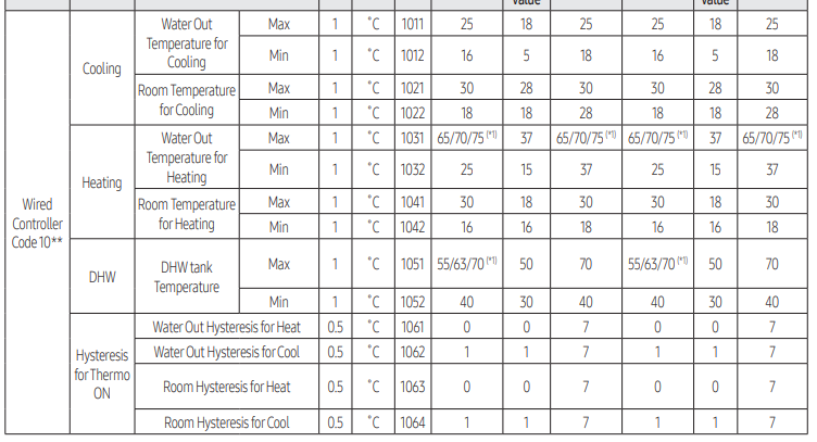

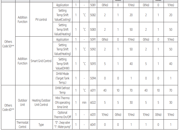

The issue with the Samsung controls is that is uses the LWT for the hysteresis of the type 2 modulation you described. When LWT reach 2 degrees above the target it turns off the compressor. However, the bottom of the hysteresis is the target LWT, which it almost immediately reaches when the compressor turns off, so it turns back on again straight away. But because RWT hasn’t had a chance to drop, it quickly reaches LWT target +2 again.

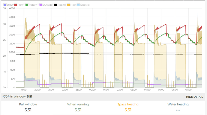

On my controller, I have a few FSVs that help. 1 that allows you to adjust the bottom of the hysteresis (FSV#1061). Which means that it doesn’t switch on straight away. You can see that in action in the graph below with that FSV set to 3.5, making the total hysteresis 5.5 degrees.

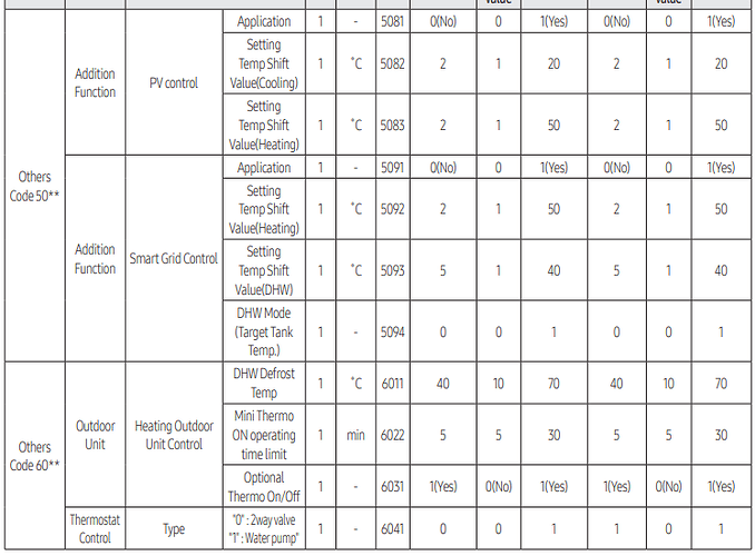

Another that sets the minimum compressor on time (FSV#6022), which means that even if it reaches the top end of the hysteresis it will stay running, this MIGHT on its own, mean that the LWT doesn’t drop immediately below the LWT target, and so could reduce cycling. The first setting seems to eliminate the need for the 2nd though.
From what I remember, this one is only accessibly through the Simple Settings, and not through the menu. Others have said that neither of these settings are available on older MIM controllers, like those sold with the HTQ.

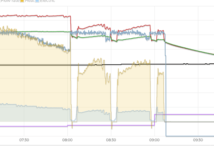

My gen 7 8kw is the same and always has been. While I accept what is said above I dont understand why it needs to do a wasteful defrost every time at these ambient and room temperatures, looks like a lot of things and conditions have not been fully thought through by Samsung….well at least to me!
It was doing 4746w out and using 904w, defrost used -400w on this screen shot.
I don’t think that’s a defrost per se. I don’t remember what the exact phrase is, something like “flash-cooling”. I think @SarahH used this phase in her ‘when is a defrost not a defrost’ thread, but I might be wrong on this.
It’s a simple consequence of shutting the compressor off, the refrigerant very rapidly cools and you see this micro heat loss as it draws heat from the circulating fluid.

Quite right, @jakeymd1, at least on a Samsung, because when the compressor stops, the main EEV opens wide and the compressor low flow recycle valve opens, to depressurise the refrig circuit. So any residual liquid at the HP end (basically the condenser) flash cools to a temperature lower than the circulating fluid, temporarily reversing heat flow in the condenser.
