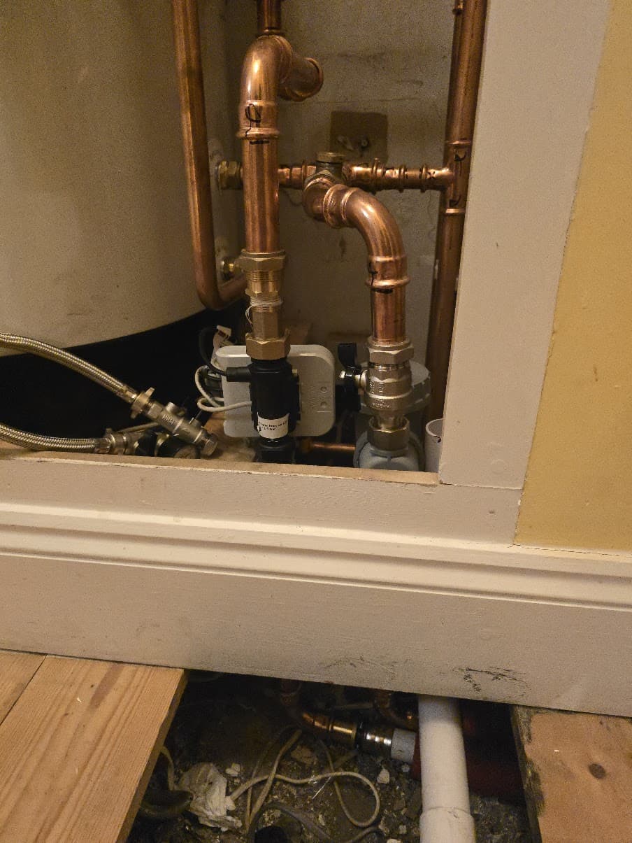

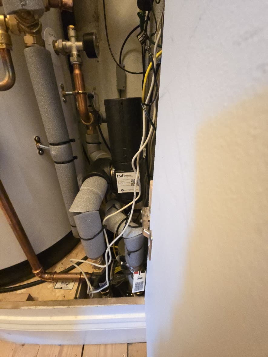

I’m in the process of having a heat pump installed, but the space is very tight. Currently the flow meter is installed near to the hot water tank, with about 20cm above before the next bend, and about 30cm below before another bend.
The instructions suggest keeping the meter on as long and streight a pipe run as possible,but I am lacking in long straight runs! How much of a real term impact is this likely to have?
The manual seems to suggest this is probably OK…but isn’t explicit about distances

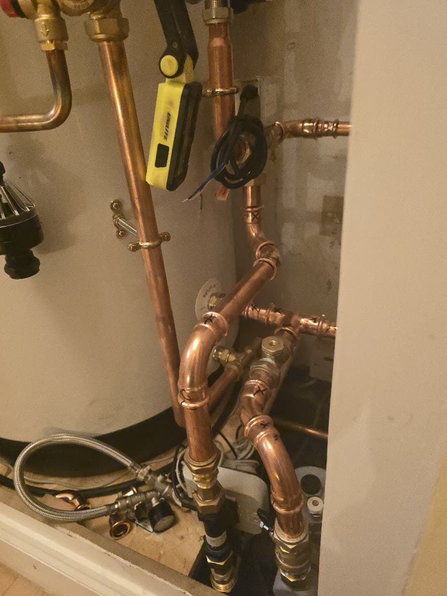

  2. It’s not clear in the photo that the flow meter has been inserted before the 3-way motorised valve that diverts the HP flow to either the HW tank or your CH emitters. Can you confirm that’s where it has been fitted?
Thanks!
Yes - I plan to remove it so I can put it somewhere more visible (and not pointing backwards!) I just need to ask the plumber to move a fitting tomorrow so I can slide it off (currently it fouls another pipe before it disengages)
I haven’t found the spare mount - but I’ll look again, and I’m sure I can work something out either way
Correct - the unit is before the motorized valve, see below
It looks like the meter is installed in position ‘D’ which is acceptable.
The guidance suggests avoid install the meter after a double bend in two planes. Your meter is installed before the double bend. So this should be fine.

The installation position of heat meters is quite forgiving, the main issue we’ve seen is errors due to air in the system:
Thanks! I wondered if it was closer to “B” - which is also acceptable (since there is a single bend before it under the floor as well, at the end of a long straight run). But OK in any event :slight_smile:

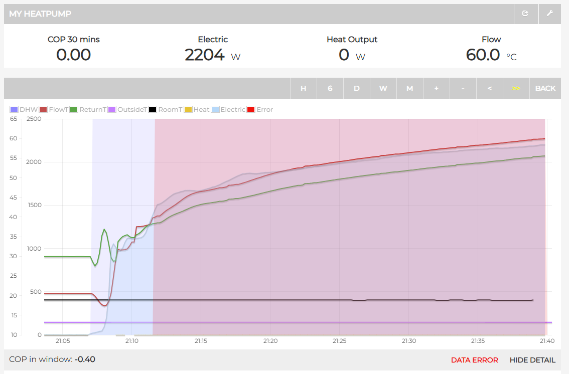

I seem to be having air bubble problems (according to emonCMS)
The plumber has run through the troubleshooting steps suggested in the emoncms portal, but so far without any success. Any other ideas…?

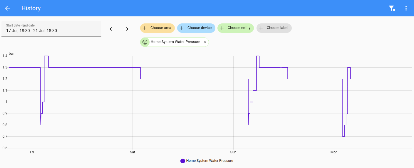

This plot shows a corresponding drop in pressure during this cycle…
I think somewhere on the flow meter specs it say minimum pressure = 1.8 bar.
You could try running your system at, or slightly above that pressure?

When cold the system is sitting at around 1.4 bar. I’ll log it tonight and see how it varies during the DHW cycle.

Yep I bled the heating last night, and topped up the pressure so that it sat at about 1.6 bar after the DHW cycle (about 1.4 bar before it)

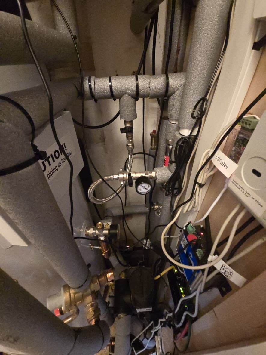

Octopus installed 5 air release points near my cylinder.
3 off AAVs at : top of coil, top of volumiser, and top of CH flow from 3-way valve.
There are also manual bleed points at bottom of coil and integral in the TF1 filter.
I found these last two useful for sampling whether there was air or not - just like a radiator bleed point.
Because I was getting so fed up with air errors I asked Octopus to fit a Spirovent that I bought. It’s in and as far as I can tell it’s working. But on reflection it might not contribute degassing very often - because unlike a gas boiler system, the high temps needed to create gassing only happen towards the end of a DHW run.
I found 2 AAV in the end, one just above the tank at the highest point in the system.
Some days i get no flow error at all, but some days it is quite bad, 90 minutes on Saturday for exanple.
It seems quite variable even when the volume of water to heat is similar
Heat geek have suggested waiting a month to see if things settle down, which they might. But since last night was the longest outage to date I’m a little sceptical!
Heat Geek came out to have a look, as I was reliably getting ~80 minutes of “no flow” air errors a night.
Testing seemed to show this was never a problem with the heating system, but only with DHW
Various de-airing tactics were tried as documented by openEergyMonitor
For now, what seemsto have resolved the issue is dropping the DHW pump speed from AUTO to 50% (CH is still on Auto)
Unsure what real world effects this may have - but one, for now, is that it seems to work without error each night

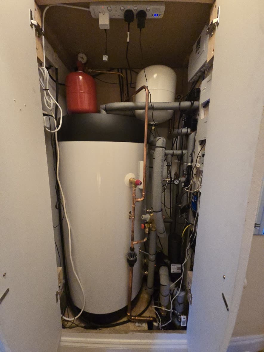

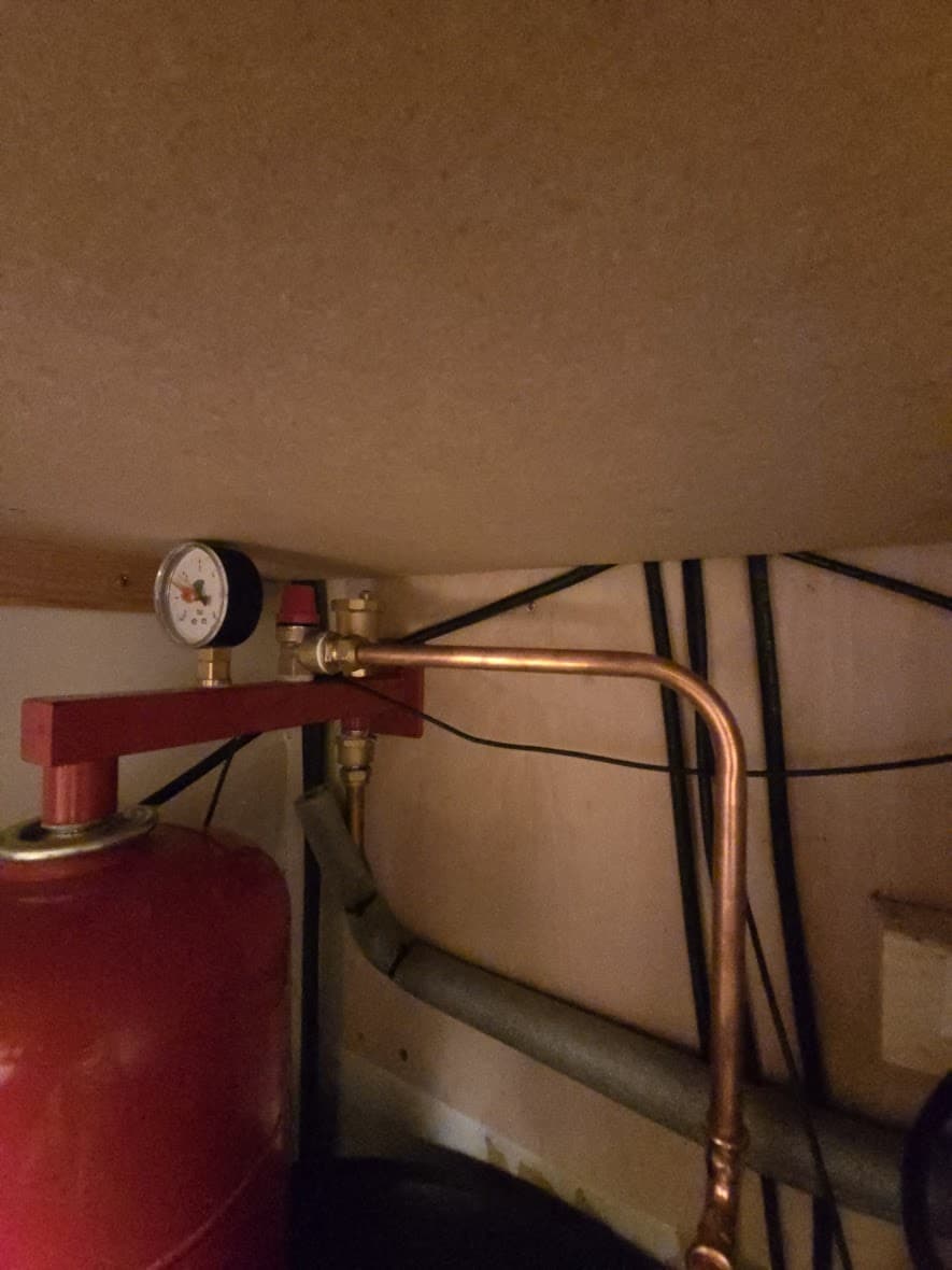

I’m assuming your AAVs (automatic air vents) are open)? Could you post some photos showing the locations of the vents on your system?
There are 2 AAV
One is on the CH circuit to the far side of the diverter valve
The other is up by the red expansion vessel (is one CH or DHW…? Can’t quite work that out)
There is also (recently fitted) a deaerator - just past the flow meter, and just before the diverter valve
When heatGeek were investigating, the air / flow problems never seemed to occur when the CH was switched in - only when heating hot water. Hence the suggested deareator.
