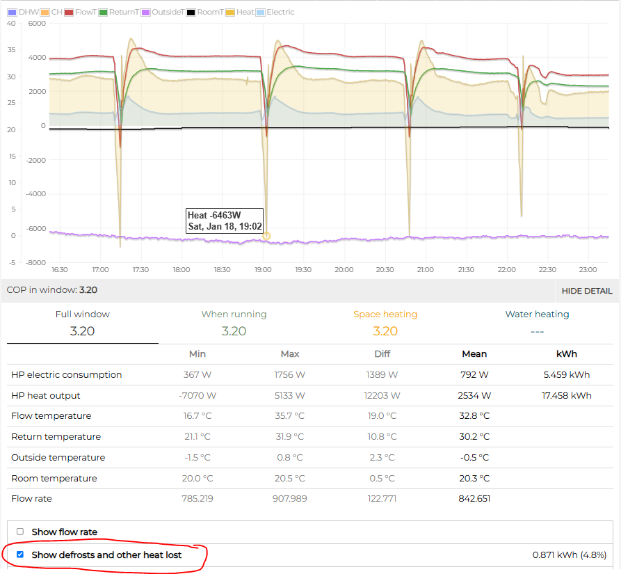

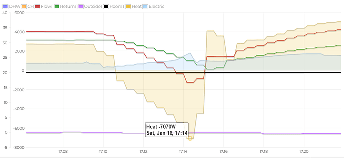

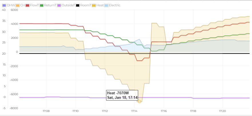

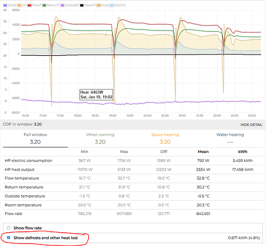

I have a Sontex and they show negative in OEM
https://emoncms.org/energystatsuk?mode=power&start=1737217320&end=1737242100&cool=1
Because the DT between flow and return is negative during a defrost, the result of the heat output calculation is therefore negative.
minus DT8 x SHC 4.2 x flow rate = minus 7kW etc
