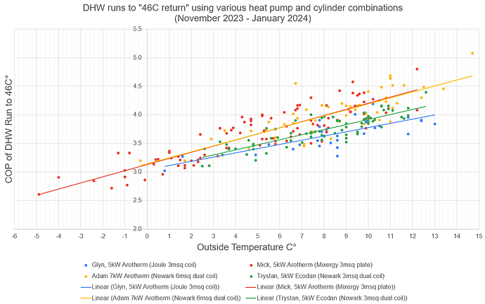

My HeatGeek in-progress proposal has just changed, replacing the Vaillant uniSTOR 200L with a Newark HG200A. Still looking at a Vaillanot Arotherm+ 7kW.
It’s a 4 bed/2 bath house, so understand that it needs to be sized for a potential family.
But since I don’t use much hot water, probably averaging less than 30l/day over a month, how do I calculate whether the Newark HG200A is likely to use more, or less, energy than the Vaillant uniSTOR 200L?
My Heat Geek wasn’t keen on the Vaillant uniSTOR 200L, but I’ll need convincing that the extra cost is justified. Looking at change in combined costs for parts and labour, it’s about £450 more. That could go towards OEM heatpump monitoring kit…
I did some research in my Mixergy article; Mixergy v HG v non-HG
How you configure the heat pump (eco mode etc) is far more important than the cylinder.
Yes, you will get slightly more performance from a Mixergy / HG cylinder, but is it enough to justify the cost?
Compare the blue (Joule) to the red/yellow (Mixergy / HG)
0.5 COP per run? Say 3.5 COP to 3.0?
30L would be about 1.5kWh of energy required
1.5kWh / COP 3.5 = 0.43kWh elec input x 29p unit price = 12.5p per run
1.5kWh / COP 3.0 = 0.5kWh elec input x 29p unit price = 14.5p per run
Obviously, more water = more energy = more cost = more savings.
But for 30L it is only 2p per hot water run?
You gonna get that £400 back?
If you were doing 250L per day, it would be more like 17p per run.
12 / 3.5 = 3.42 x 29p = 99p
12 / 3 = 4 x 29p = £1.16
17p x 365 = £62
So 6.5 years to get your money back perhaps?
