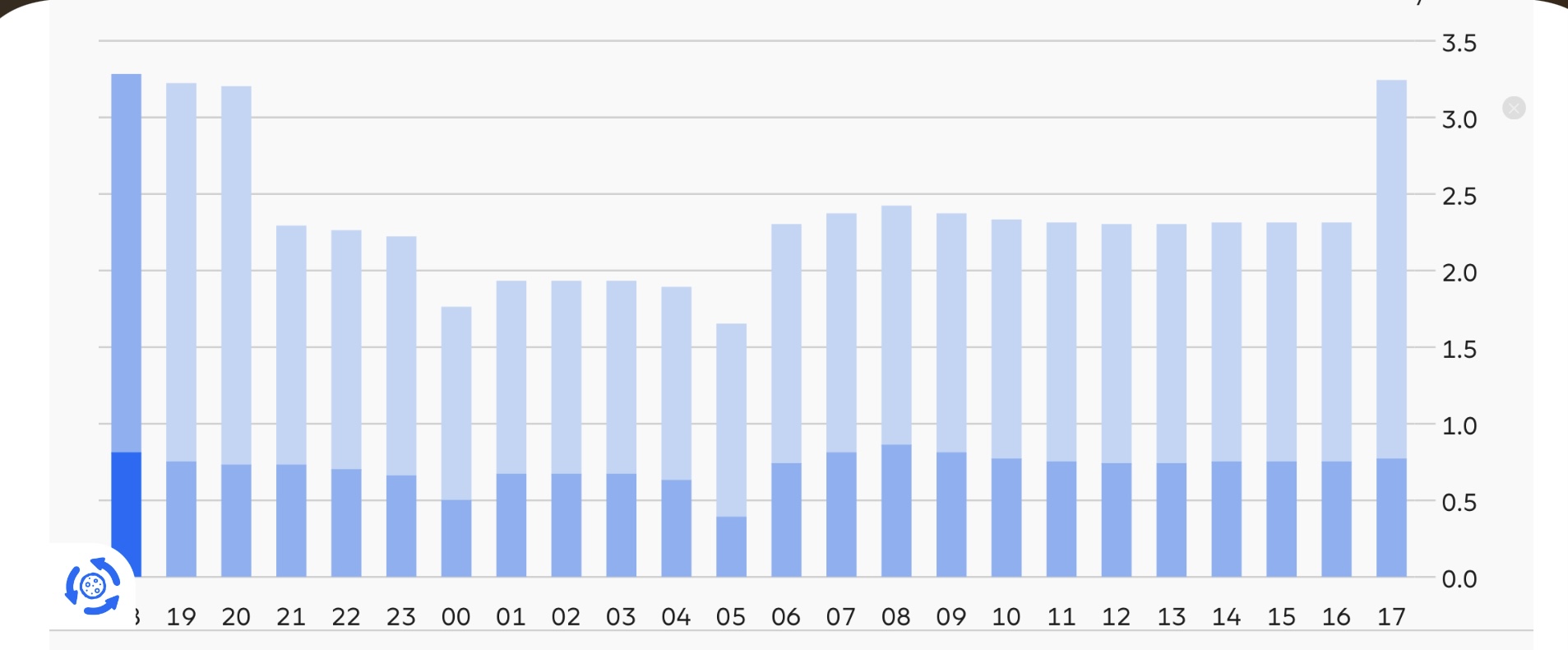

There are some very valid points here!
In Denmark we don’t that an off peak tariff as such it is variable rate hour for hour based energy consumption on the net and on how windy it is etc.
Below is an example of a typical variable tariff for today including transport tariffs etc.
I do have a Solar PV setup but no battery as we use 3 phase electricity and buying 3 battery inverters plus batteries are pretty expensive here… but something I do hope to do in the future when I replace my main SMA TriPower solar inverter for a hybrid inverter.
Based on this I guess it would be a very adhoc approach to try and optimise my evergy and cost usage.
