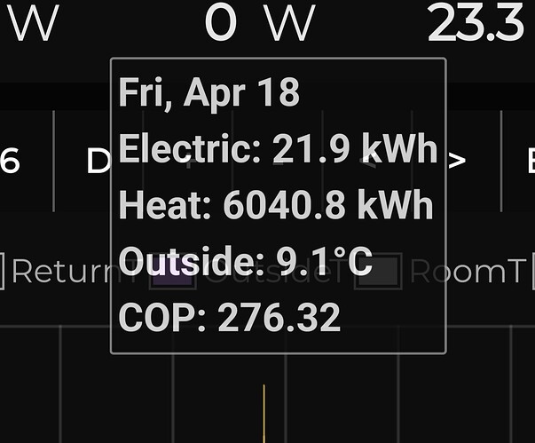

The top of the SCOP table is flawed. What’s the point in ranking systems when a lot of the individual SCOP figures are just plain wrong? Some of the heat pumps listed near the top should actually be much further down—only reason they’re up there is because of outlier days showing wildly inflated COPs, some over 300! I get that it can be taken as a bit of craic, but if we’re using this data to show clients what’s realistically achievable, it needs to be accurate.

Quite a few systems showing scop of >4 due to a few over inflated days
This is a good example

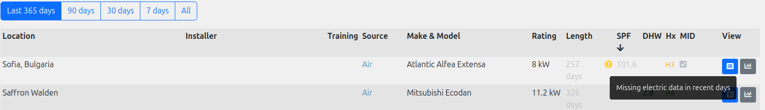

Looks like this system has been flagged as having metering errors and is no longer on the main leader board:
Please let us know if you see any others with issues like this and we will flag them as having metering errors.

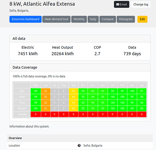

Fixed the error on the Sofia one (HeatpumpMonitor.org)
Please let us know if you see any other errors, as far as I can see the others at the top all look fine. If you can share the systemID that would be really helpful.
