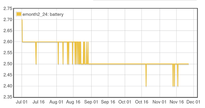

V1 or V2? You might have a fault on yours. I have an emonTH2 running on two black eneloop pro cells, it started at 2.7 V in July and it’s now touching 2.4 V, with an external DS18B20 connected.

Mine:
@TrystanLea ?
