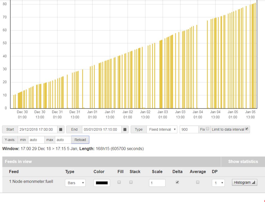

I just recently installed my emonPi and I could use some help with the “delta” feature of graphs. For now the only node I have is a custom arduino-based node that reports water and fuel consumption over the radio.
The node reports the total index to date (and restarts at zero whenever the arduino is restarted). It sends data at most once every 30s, and only if the index has changed.
I have those two feeds:
For the inputs I simply used “log to feed” and PHPFINA Fixed in 30s
What I am trying to do is create graphs that show hourly and/or daily fuel and water consumption. I tried quite a few settings in the Graph view but I am not getting anywhere… mostly because I don’t understand precisely what the expectations are w.r.t. the underlying data.
Here are two sample graphs: the default one for “water”, and the same graph after selecting “delta” and reloading; a couple bars do show a correct delta, but most of them apparently show “index - 0”.
I assume that missing values are a problem - how would you recommend that I set up my inputs, feed and graphs to be able to create nice graphs showing consumption over arbitrary periods (e.g. anywhere from per minute to per month)?
Is there somewhere a detailed explanation of how the graph options (“Type”, the number next to “Type”, “Fix” checkbox, “Delta”, “DP”…) are used to drive the processing?

Default graph:
With “deltas” selected:

That is a better solution, if you look at the example data you posted eg
1546699500, 822
1546700400, null
1546701300, null
1546702200, 825
We can tell that 3 units were used over the 15mins between 1546701300 and 1546702200 (12 unit/hr for 15mins) following no activity for 30mins. BUT, in emoncms graphs this will appear as 3 units used over the 45mins between 1546699500 and 1546702200 (4 units/hour for 45mins) due to the nulls in place of zeros. Since the zero activity is just as informative as the non-zero values, and they make no impact on the file size on disc, there seems little point in not sending the zero readings unless you are using a really tight gsm data plan to send the data (and even then it might be worth considering). The data
1546699500, 822
1546700400, 0
1546701300, 0
1546702200, 825
would graph as expected.
