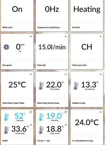

Flow rate
My flow rate never seems to drop below 13.33L/min, even when the compressor and fans are off. I went into the service menu (1234) and set the Standby Pump Speed to 0 (and the Minimum Pump Speed to 20) but my changes seem to be reverted instantly.
Is it a problem that the pump is always running, no matter what? It seems pointless to be running it if the heat pump isn’t doing anything.
When it’s actively heating the flow rate is more like 18-23L/min, with a delta T of around 3c. I would like to try experiment with a lower flow rate, but as I mentioned my changes to those settings are ignore/instantly reverted. I’ve tried changing via the econet24 web interface and the smart controller touch screen, same result
Right now, the heat pump is doing nothing and has a flow rate of 15L/min

No matter what, on the smart controller touch screen the red heating demand icon is active (even if the compressor/fan are off). On the econet24 web interface it says the demand is heating, work state is on, but compressor/fans are at 0

I have been experimenting a bit with Room temperature correction, moving between 0, 2 and 4 but I can’t really seem to work out what it’s doing in reality.
My understand (please do correct me if I’m mistaken) is that with Thermostat pump blockade set to off, the heat pump won’t just shut off when the target temperature is achieved, but will instead decrease the flow temp. by whatever Decreasing fixed water temperature is set to. Only when the flow temp falls below some value (?) will the heat pump stop working.
I’m really not sure what the Room temperature correction does in this scenario. At 0 it’s presumably off entirely, so does it just completely ignore the thermostat? Or does it still use the thermostat value to reduce the flow temp as I outlined in the paragraph above?
My goal is like what many of you strive for, to have the heat pump cycle as little as possible and work ‘low and slow’ to maintain and consistent temperature in the house. Please, if you have any advice on settings I can change to achieve this I’m all ears.
I have been reading through the length Grant thread and saw in this post that there is a limit of 25 on the standby pump option and 30 on the minimum
I can confirm after updating my minimum to 30 the flow rate immediately dropped from 18.33L/min to 13.3L/min
The compressor also seemed to immediately work less hard, despite outdoor temps continuing to drop - so reducing the minimum flow rate has improved the efficiency? Makes you wonder why it has a default minimum of 50%… delta T remains the same at around 3c
I also really don’t understand why when the heat pump is idle for a long time it doesn’t stop pumping water. I may ring Grant this week and ask.
The reason the pump keeps running even if the heatpump isn’t working is the “Thermostat pump blockade: NO” setting. For some reason this keeps pump running with standby speed when compressor is off.
If you set it to yes on your active circuits it stops. But as you said you’d lose the “smart” flow temperature reduction with this which itself is a really nice feature.
This bit of the controller isn’t particularly well thought through tbh.
I’ve got the home assistant Integration detecting this and turn pump blockage dynamically on,off to avoid the pump unnecessarily running.
yes, unless the water keeps circulating the pump can’t properly measure its temperature. is really not a big issue, helps move heat from my conservatory (45c in the sun) to other parts of the house. Uses all of 10 watts, and keeps the crud from settling.
The default minimum was presumably so it would work if you had 100M of lousy microbore pipe in your system, though why no feedback control between flow rate and pump speed .. well, chinese not as cunning as feared i guess.
You can still use weather comp with blockade on. What you can’t do is use room influence to reduce flow temp when the room is hotter thn the thermostat set point … no point, becase there is no circulation if pump blockade is on, which is a bit binary, but effective.
