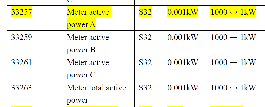

Thanks for posting that. Helps a lot.
It says register 33094 holds the grid frequency value.
Registers 33257, 259, 261 and 263 hold the active power values. To convert them to kW,
simply divide by 1000. They are Signed 32-bit values vice the Unsigned 16-bit values
we dealt with earlier.
Value is 327876611 via instrument.read_long(33094, functioncode=4, signed=False) from python but I assume that value needs converting
It’s signed, so that parameter needs to be set to True.
327614467 with it as signed=True

It’s just strange that the read register doesn’t work instrument.read_register(33094, functioncode=4, signed=True)
You’re referring to minimalmodbus, correct?
Yes API for MinimalModbus — MinimalModbus 2.0.1 documentation
That’s because read_register handles 16-bit values. Viz:
Yeah but also tried 33035 which is a U16 and still didn’t work whereas read_long did return a vlaue
What results did you get when you tried to read register 33035 with read_register?
Nothing goes into an exception
I’m thinking we still don’t have the addressing quite right yet.
The line freq value is a 16-bit number, which means there should be no problems reading it
with the read_register function.
