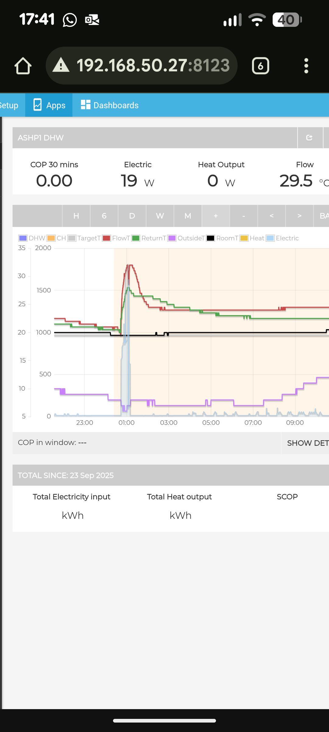

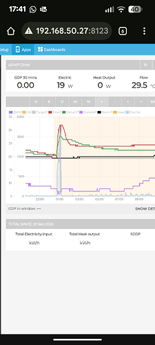

After a few days playing I’ve got my first graph. Nice. Luckily DHW was running so I could monitor for any issues.

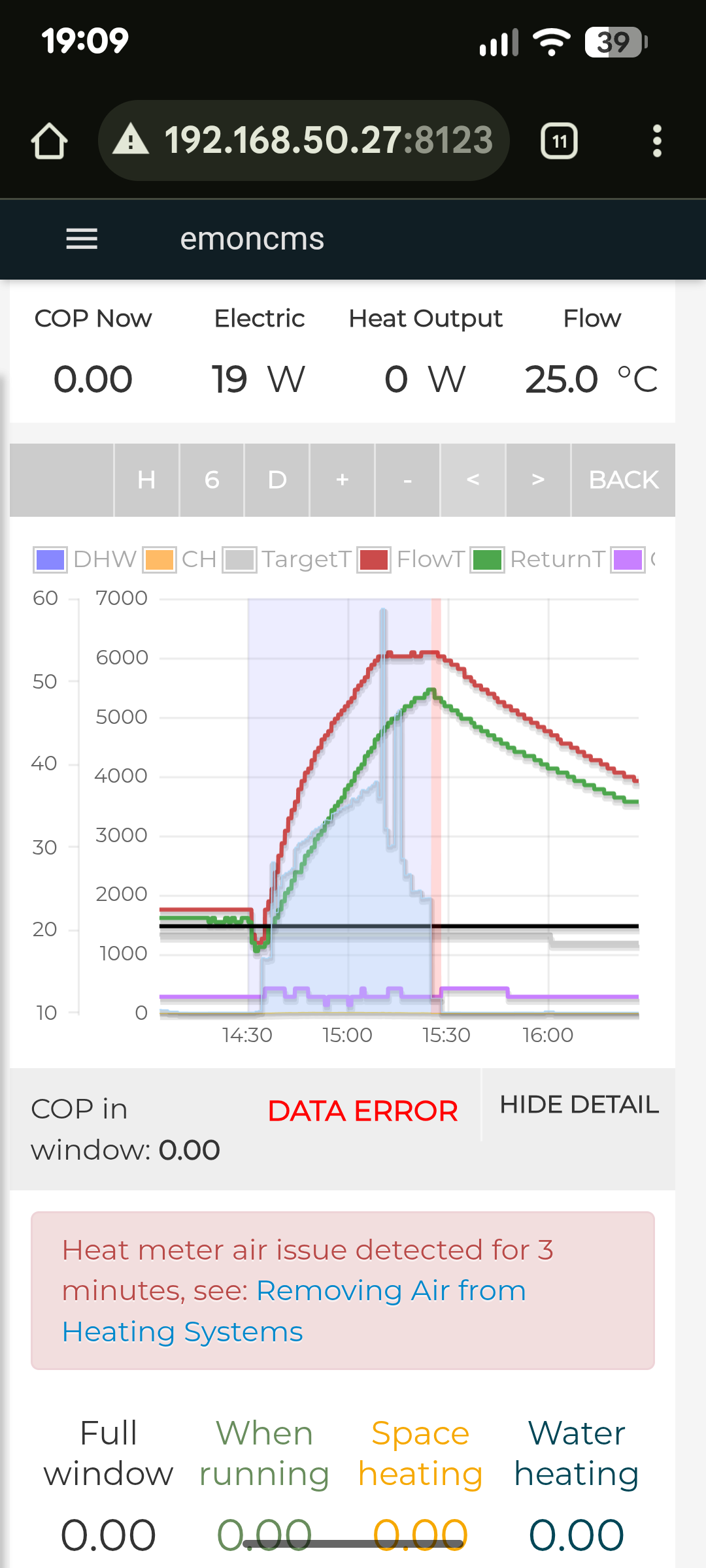

When the DHW finished i got a false positive for air in the system. Is this something I have to live with or can I change settings within emoncms to ignore the ASHP powering down?
The other minor issue is the max power spike. I’ll change the esp32 Yaml to clean up the data.

Evening. All fixed. I had to x1000 on the heat output feed.
