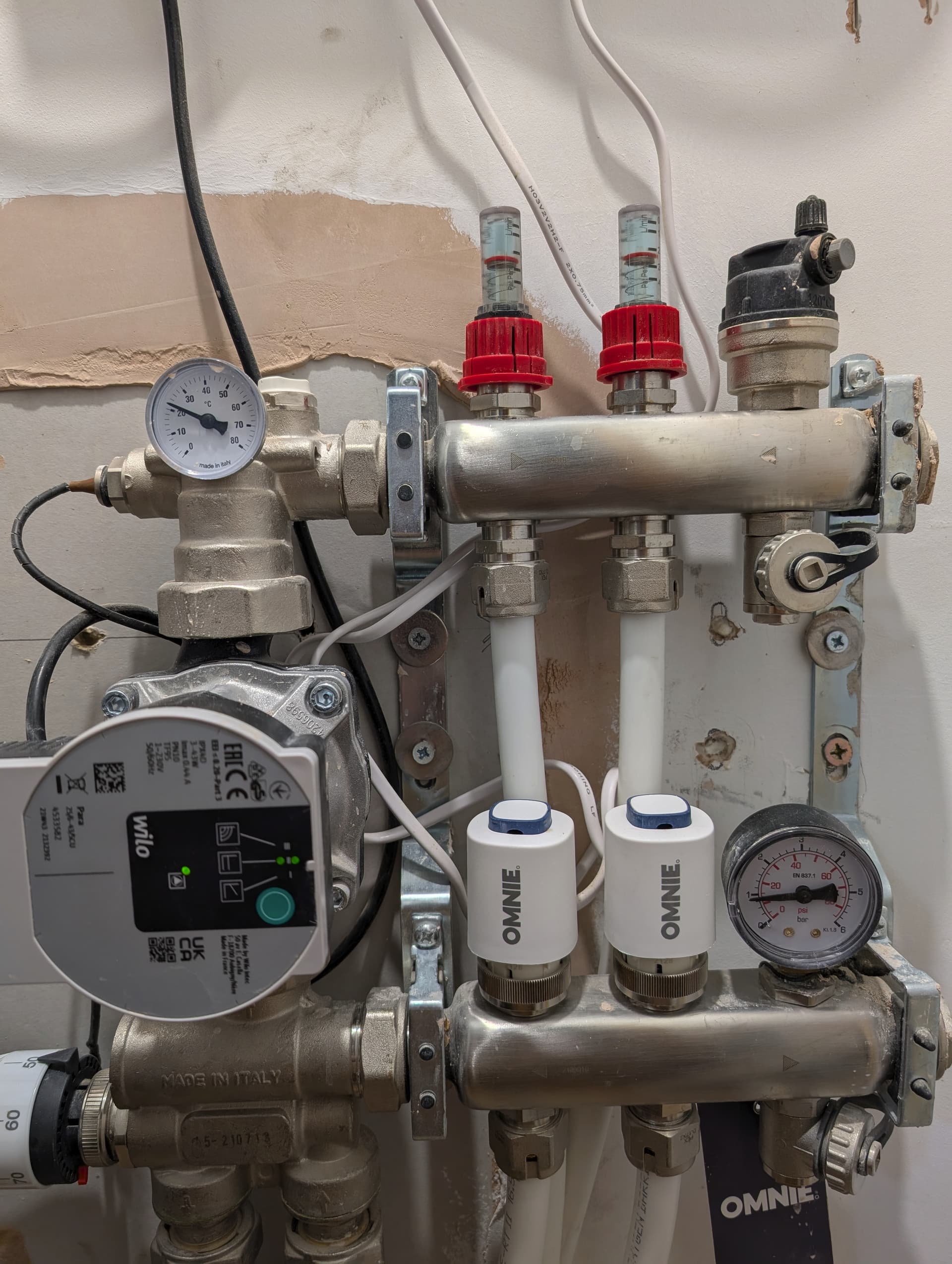

I have UFH downstairs currently set up in two zones at a central manifold, and then 3 radiators upstairs with a wireless thermostat 2 bed mid terraced house. Internal walls insulated, double glazing and loft insulation
Currently running with a weather compensation curve that was straight up copied from youtube, have been given essentially zero guidance from installer and any opinions would be greatly appreciated.

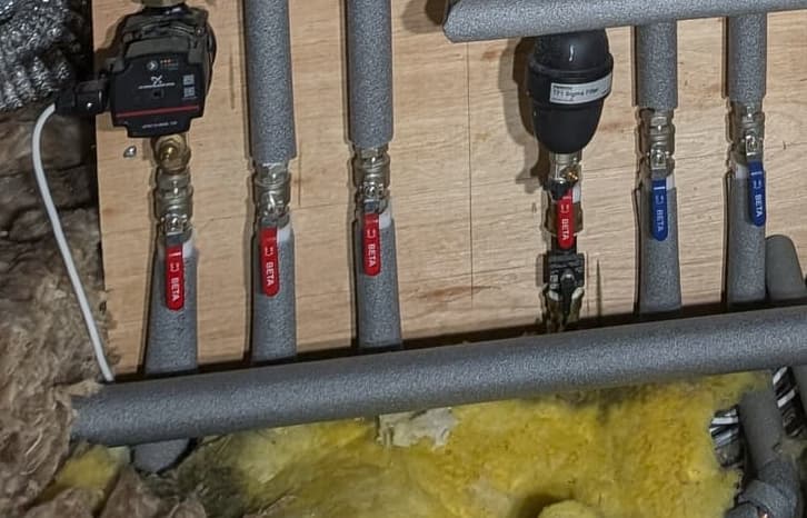

Hopefully these images help paint a picture
Manifold with Omnie wiring centre above
Installation in loft
Current compensation curve

I’m guessing that the primary flow and return pipes are in the bottom-left of the loft picture, beneath the yellow insulation? It would be worth finding and checking the two temperature probes that will be on those pipes, and check that have been fitted securely.
(leftmost red valve is probably flow, rightmost red valve is return)

I have found the temperature sensors on the far left(under the pump) and the 4th from the left (under the filter). Not sure what I was expecting,
RHS under filter
LHS under Pump

  • The flow sensor looks like a Sika. The Sika data sheet has this to say …
Vortex flow sensors are not completely independent of the flow profile due to their principle. A calming section is therefore necessary. In order to achieve the highest possible measuring accuracy, straight inlet and outlet pipes with an appropriate inner diameter should be used (VVX15 = 13 mm • VVX20 = 9 mm • VVX25 = 25 mm • VVX32 = 32 mm • VVX40 = 40 mm).
  • The temperature sensors look like they are strapped to the pipe with insulating tape! They should be firmly attached to the pipe (purpose designed clip, maybe Jubilee Clip in extremis) with heat transfer paste between the sensor and the pipe. Then the whole section of pipe should be covered with insulation, the more the better. You might then get a reasonable approximation to the temperature of the water flowing in the pipe.

I have inquired for some Hebotec TFC6 22, which seem to be about the best for the job without replacing the probe with its own clamp? For paste will thermal compound used in PC building be sufficient here?
As for the flow sensor does seem like poor placement, will look to getting that moved at the first convenient time. Though not sure where on the run its on it could be improved, with the two Ts further up.
Looks ideal. Spring clip so will expand/contract with pipe
Yep, fine.
To be fair, they at least put a swept bend after it, and I assume the valve just out of shot is a full flow ball valve, if not might be worth changing.
Problem with badly installed sensors is that you are only looking at measuring small differences in temperature, sometimes dTs as low as 2 degrees, so even small errors will lead to misleading COP results.
