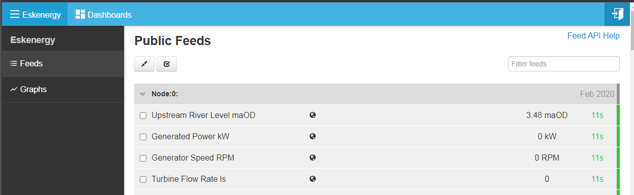

Feeds visible in menu when not logged in
Just upgraded to V11.7.4 and Feeds and Graphs are visible when not logged in.
This was what was shown by going to the dashboards when not logged in
The ‘door’ on the right shows I wasn’t logged in.

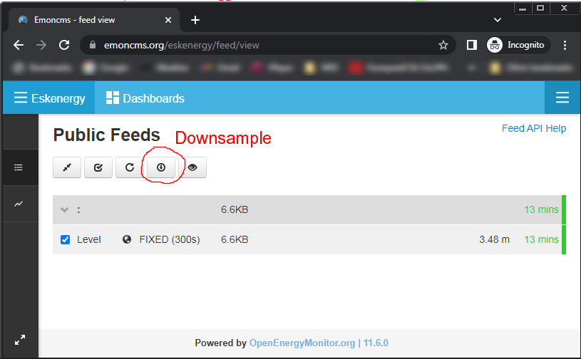

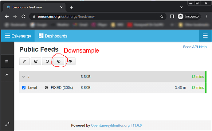

Sorry to keep posting but this IS a security issue.

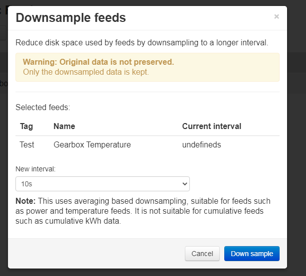

It seems any non-logged in user can go to Feeds and downsample them.
There’s a warning its permanent
This can’t be right…
Do others see Feeds and Graphs on the dashboard menus when not logged in?
Double checked by creating a temporary account on emoncms.org
Feeds are visible and can be downsampled by anybody.
Surely a security/vulnerability issue?
