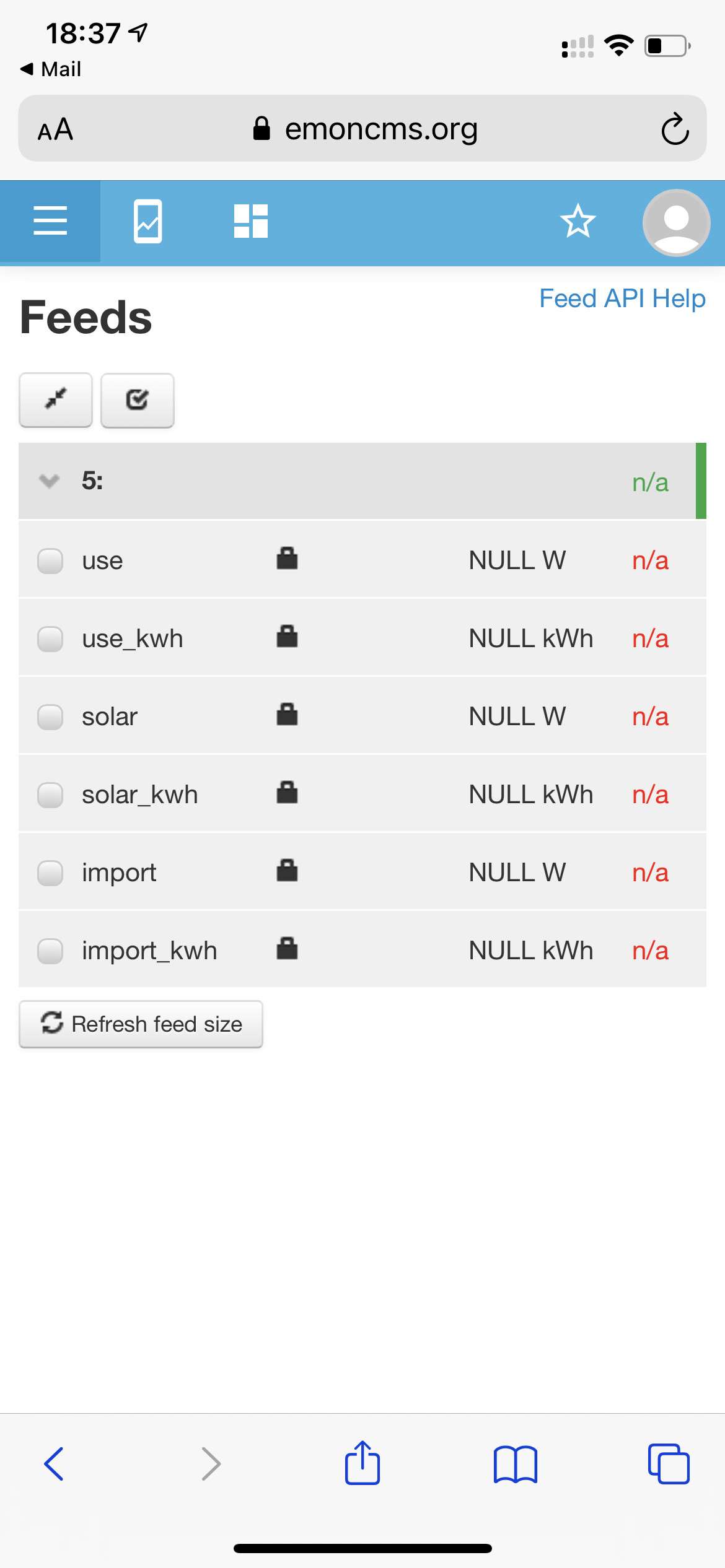

Anything that I might be doing wrong? Ive added the emoncms.org API into the emonHub locally and it creates the inputs under a completely different node name. But the feeds are all messed up. Two pictures attached - one of the local feeds and the other of what appears in emoncms.org
Hello @neiloakley could you share a screenshot of the inputs page on the emoncms.org account, it looks like the inputs are not yet mapped to the feeds correctly?
If you are logging the data locally have you considered using a remote access solution to access your local data remotely? We have a guide on how to set this up here Remote Access - Guide | OpenEnergyMonitor it avoids the complication of having two separate locations like this.
