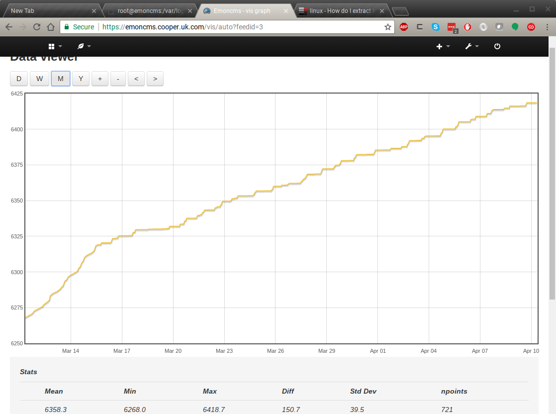

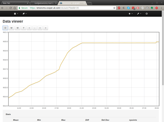

I periodically update my standalone emoncms install from the master branch on GitHub. Since March 15th my feeds haven’t been updating correctly. I’ve checked logs and there are no errors. Any ideas what to check?
If I run power_to_kwh.php from useful scripts it builds a new feed perfectly.

I fixed the issue. As I was using an old CentOS 6 OS I used this as an excuse to upgrade to a new Ubuntu 16.10 machine.
I copied my existing data manually by copying the files from /var/lib/phpfina onto the new server. I manually created my feeds then replaced the files in /var/lib/phpfina with the backups from my old servers. I stopped apache while copying the files and flushed reddis before starting it again. I rebuilt my kwh using the useful script power_to_kwh.php.
So far so good!
