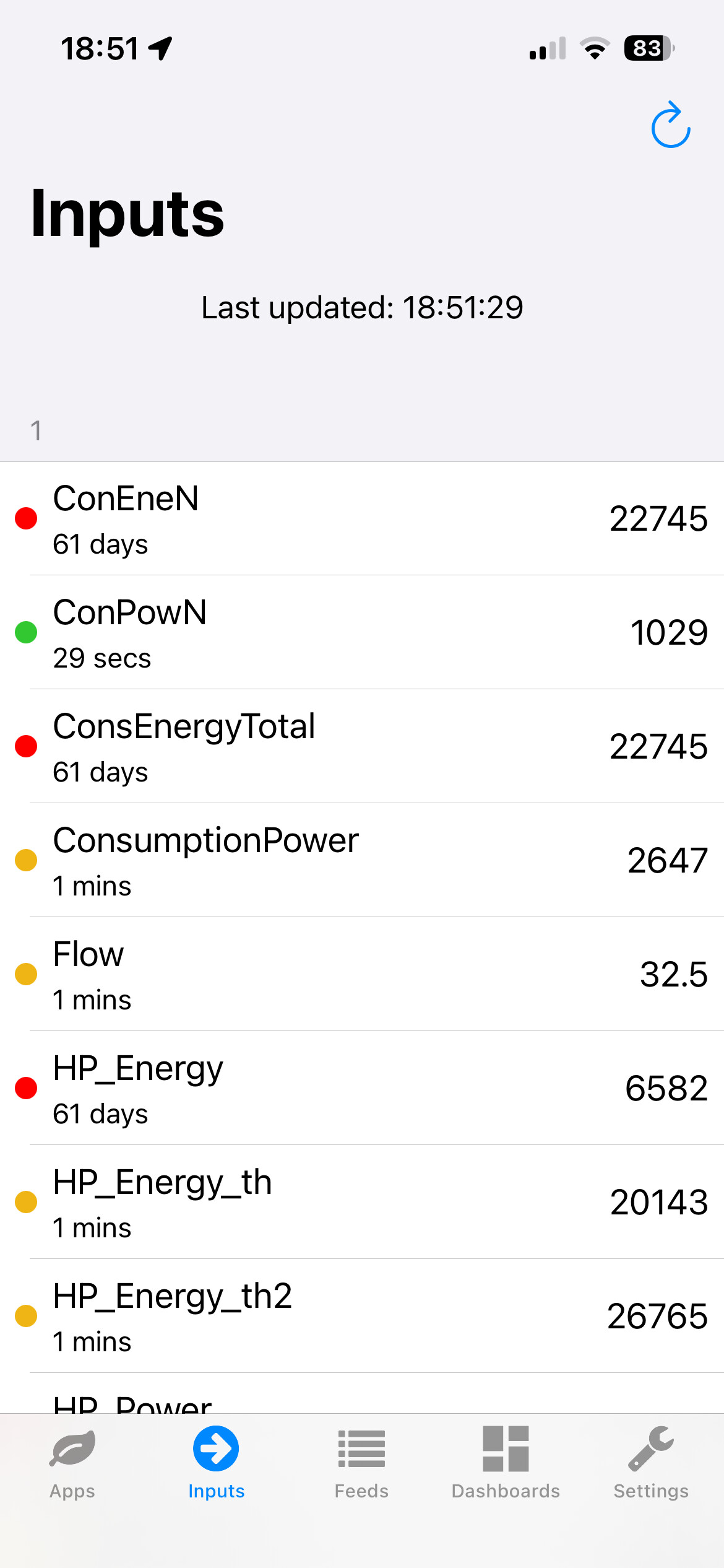

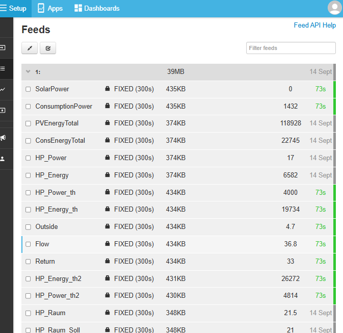

I have setup 34 feeds around this time last year and on September 14th 12 of them stopped receiving data. I send those from my openHAB system with the same routine, so I don´t believe something is wrong on the sender side.
So I thought there might be a limit for the amount of feeds or inputs, but so far I researched that it might be 100 feeds. Any idea what might have stopped those feeds? See image below
Thanks for any help in advance
Erik
Hi Erik, What’s happening on the Input screen with the Inputs that correspond to these feeds, or which calculates them? Are they also stuck on this date?
Same thing, inputs stopped receiving data on the same date
That would seem to suggest a hardware problem? Do all these inputs come from a remote board being fed by WiFi or USB, or are they remote sensors for temperature? Need more information on what the actual feeds are really.
Hi Richard,
all the inputs come from different hardware they get collected and thent sent from my openhab system. I did some further debugging and I think I found the issue. Some of those items in openhab now have a unit with the numbers and those units (kWh etc.) get sent as well. That must have happened after an upgrade on the oprehab system. Will now try to send the numbers without any units and see if that fixes the issue. Thank you so much for pointing me in the right direction!
It works again!
Learning: Don´t transmit any readings with units!
