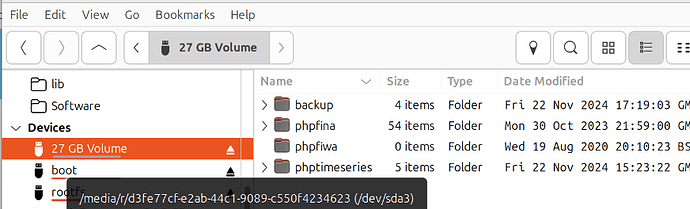

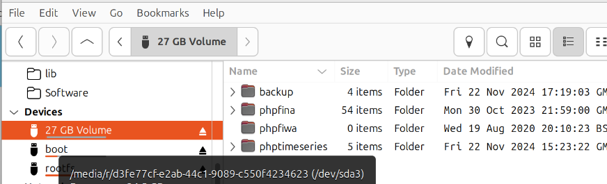

The .dat files are at var/opt/emoncms/phpfina - likewise var/opt/emoncms/php/phpfiwa and var/opt/emoncms/phptimeseries for the other Feeds’ data files.
The way I found them is first, I mounted the SD card (actually, an old one) on my laptop, and the data files are in the 3rd partition.
Then mount in the RPI showed the mount point of that partition (/dev/mmcblk0p3) as being /var/opt/emoncms. And that is the parent folder of the 3 data file directories.
