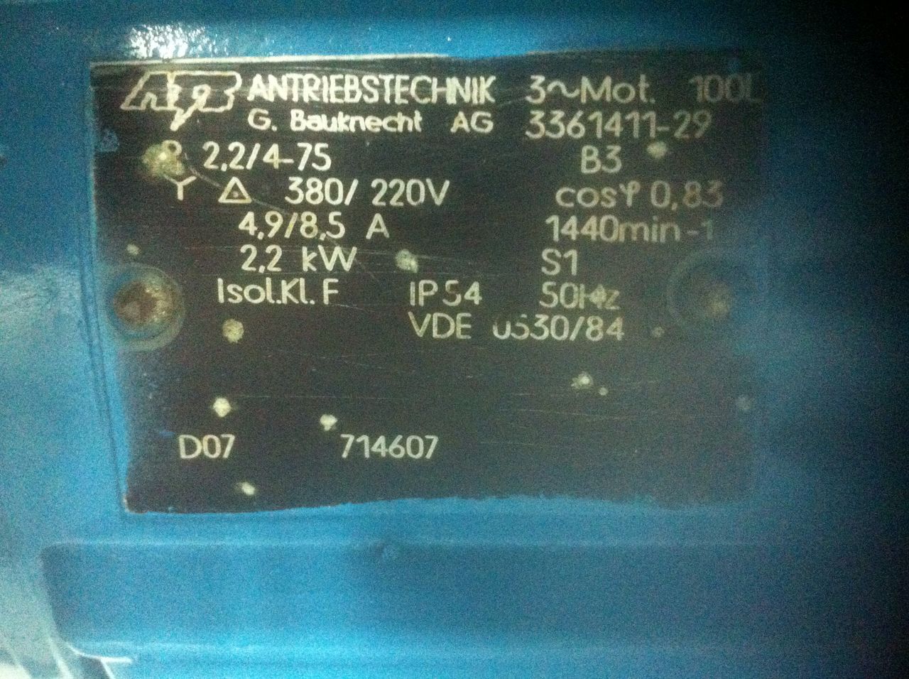

You don’t say the size of your motor, so I cannot guess what currents will be involved. But that will have a significant effect on your choice of device. You need to look at manufacturers’ websites and consider the performance (and cost) of the various options.
One more question which type of Hall effect current transducer do u think is better, closed loop or open loop?
That’s only a small motor, so well within the range of Hall effect i.c’s. (e.g. ACS712)
