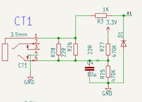

Here is your problem – the input circuit of the emonPi V1:
(This is essentially the same as the diagram in Docs, which is wrong for the emonPi2 & emonTx4 and subsequent versions.
You can see the a.c. ground actually floats at 1.65 V d.c. above true GND, and is the plug TIP. The signal is on the plug sleeve. I would advise a twin core screened microphone cable, with the screen connected only at the Pi end to true GND, the two cores to the tip and sleeve of the plug, and to the cores of the c.t. cable ignoring the screen. Try to keep the polarity of the cable cores as they were, however if it reads with the wrong sign, either reverse the c.t. on its cable or add a ×(-1) in emonHub OR in emonCMS.
I would solder every time unless it is completely impractical.
Oh yes it does. I never understood why this configuration had been adopted, @rupert provided an explanation for why it is particularly bad in the presence of noise from a SMPS in a PM to Trystan, which as far as I know has never been published.

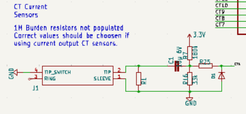

Following that, everything since the emonPi V1 and emonTx3 has the “earthy” side of the input connected to GND, not floating at 1.65 V d.c. above GND.
EmonPi 2 c.t. input circuit.
R1 is provision for a burden if a current-output c.t. must be used.

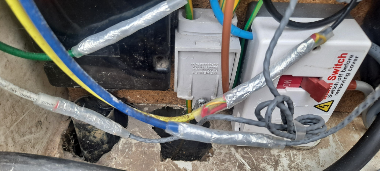

Just add a little,.. I had the same issue,.. I could monitor within my consumer unit,.. but needed some ‘extra long’ cables to be able to monitor within the DNO box,.. in order to monitor different property supply’s, eg house, garage, car.
The cable I used was this:- Van Damme XKE Microphone Balanced Pro-Patch Cable, 2 Core and Screen (Thin) | eBay UK
It maybe a premium microphone cable,.. but it does the job of current cable extension very nicely.
It did take a while to make of connections,.. but as noted above I did earth/screen the cable at the TX4 end., then at the other new end I used the screen as a connection to some foil, but not electrically connected, ( salvaged from some other screened cable ),.. to screen the soldered connections, which were insulated with heat shrink, to try and ensure a ‘good screen’,.. and clean signal.
have attached picture of my final efforts,.. I used some clear glued heat-shrink,.. which ( hopefully ) made for a better IP rating within the joint.
