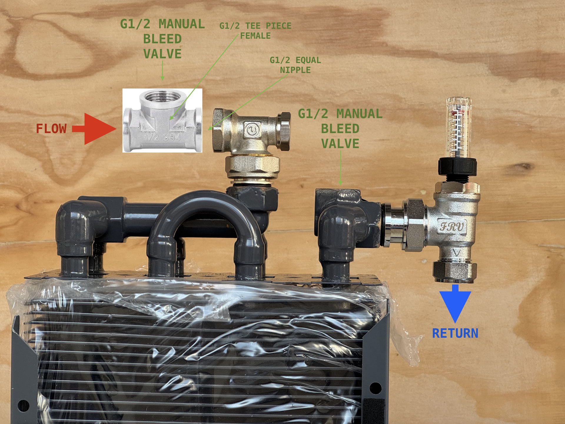

Anyone with experience of plumbing up rads in funky orientations up for advising on this?
Looking to fit a Jaga Strada heat exchanger in a vertical orientation, which it’s not designed to do, so I’m brainstorming venting/bleeding options to prevent airlocks. Would the below work? 2x manual bleed valves, each positioned at the highest point per flow/return bends.
Ignore the U-shaped grey bend, this won’t be there on the specific type (Type 15) of heat exchanger I’ll be mounting vertically.
If you have a SpiroVent microbubble deaerators on the flow from boiler/heatpump, run system hot, turn of all other radators to force fast full flow var a single radator, it will slowly remove all air from the radator.
(We have many very long pipes in our loft with “hightpoints” due to the ceiling not being 100% level…)
