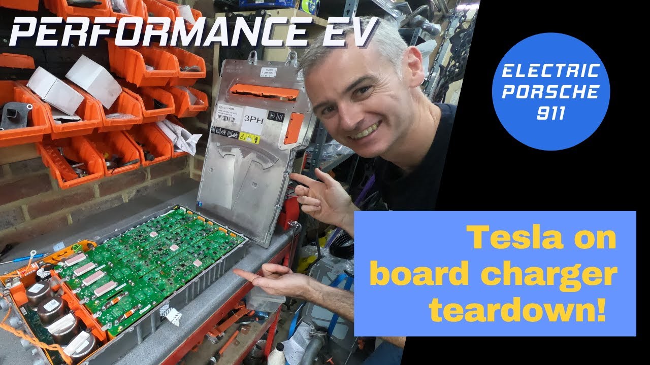

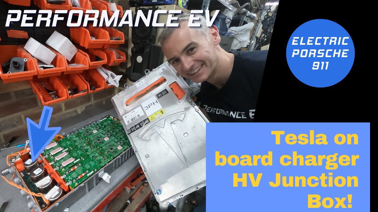

There’s a tear down of the Euro version of the Tesla charger here…
In that particular charger at least, there are indeed three single-phase modules connected in star at the a.c. side, and paralleled at the d.c. side. It was also inferred (“he thought”) that the US version is connected at 240 V across both legs, using 2 line terminals to one leg of the supply and one line and the neutral terminal to the other leg, thus using two modules in parallel; which makes sense.
