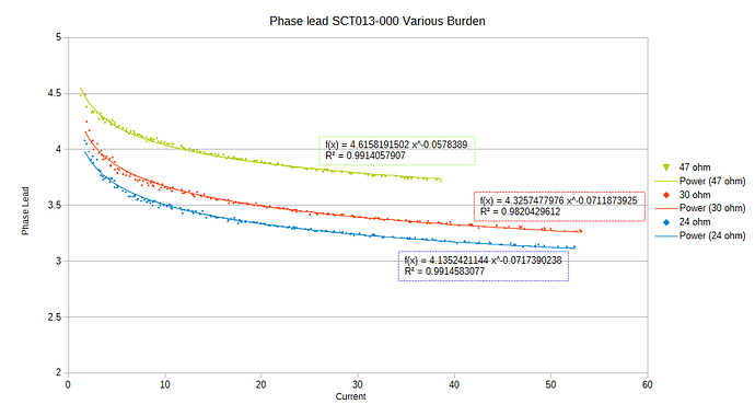

Been developing a lot of calibration data and thought I’d share this phase-lead info for the SCT013-000 with various burdens in case you might be wanting to fine tune. Don’t forget to subtract the phase lead of the Voltage Transformer to get a net correction. Some of the high indicated lead at very low currents is suspect, but the trend seems reliable. At 5A and above, I can correct out about 80% of the indicated lead by shifting the CT data the indicated number of degrees.
I think you’ll find rather more information in the report for the said CT, in Resources.

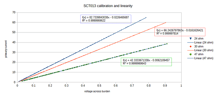

I agree. That’s an excellent report with regard to the eMonTX. Consider this information supplemental and supportive of that report’s findings. What I found to be useful here was the idea that the phase shift can actually be estimated as a pretty straightforward function of current. That’s implied in the report’s logarithmic plot, but not in sufficient detail to actually develop the function. This data does that.
Here’s some more details to support the linearity findings. Note that the trend line equations are the calibration values for the particular CT-burden combination.

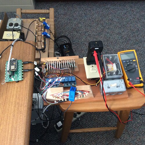

I put this data out there because it’s the product of an effort to make an automated calibration device based on an unaltered (except for software) IoTaWatt and a low voltage test device inspired by Mr. Wall’s description of his sound card test apparatus.
Note that the apparatus collects about 150 data points in about a minute. The results are copied into spreadsheets for graphing. So while this may be “rather” less information than the original report, it provides a basis to generate quick and accurate data on virtually all of the available CTs out there. I can tell you that there are some pretty expensive CT’s that test identically to much less expensive brand-X CT’s on eBay.
