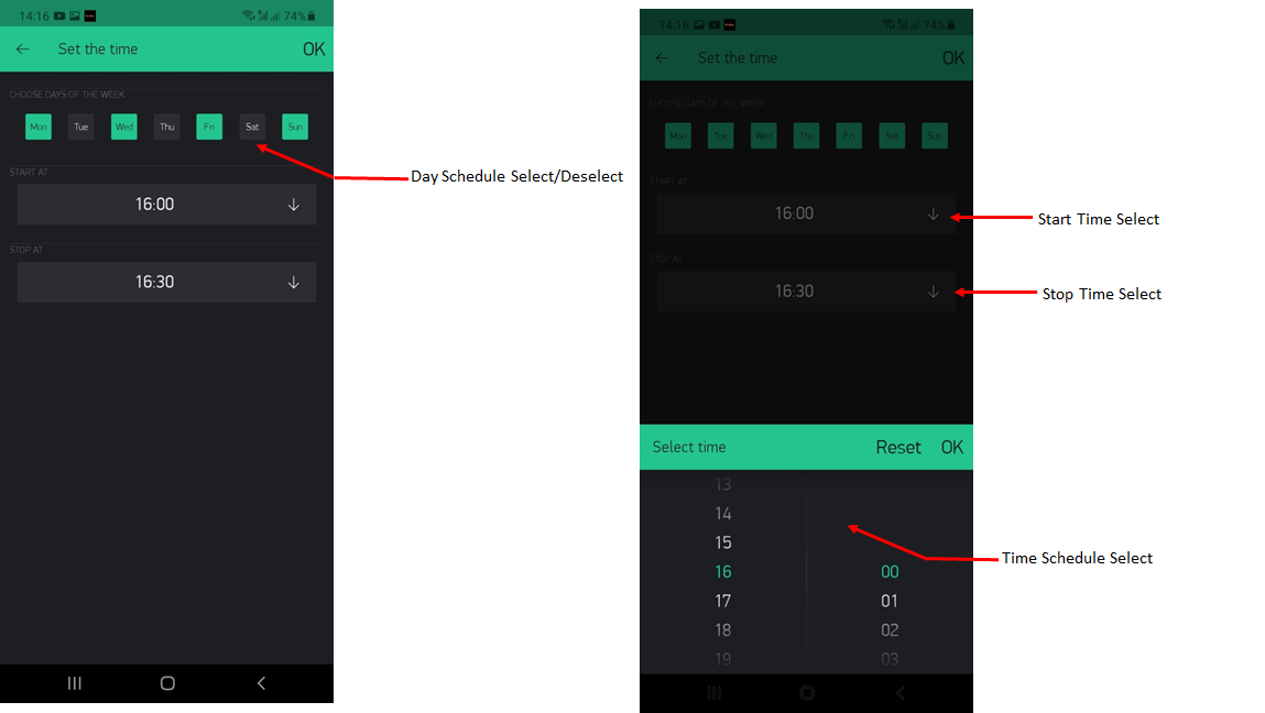

  • WiFi Manager to remotely setup your WiFi Credentials / Blynk Token from your smartphone
  • AM & PM schedule programming
  • Day of the week programming
  • Holiday Mode (Ever forget to switch off your geyser before going on holiday or on a business trip?)
  • Need to shower shortly? Override to force the Geyser ON
  • Visual feedback on health status and schedule times

Blynk 2.0 has replaced this old version of software, the hardware remains the same. I am in the process of porting the software to 2.0 and it is proving to be a bit of a challenge. However I am making progress and will update when available. See progress of the new smartphone interface below
