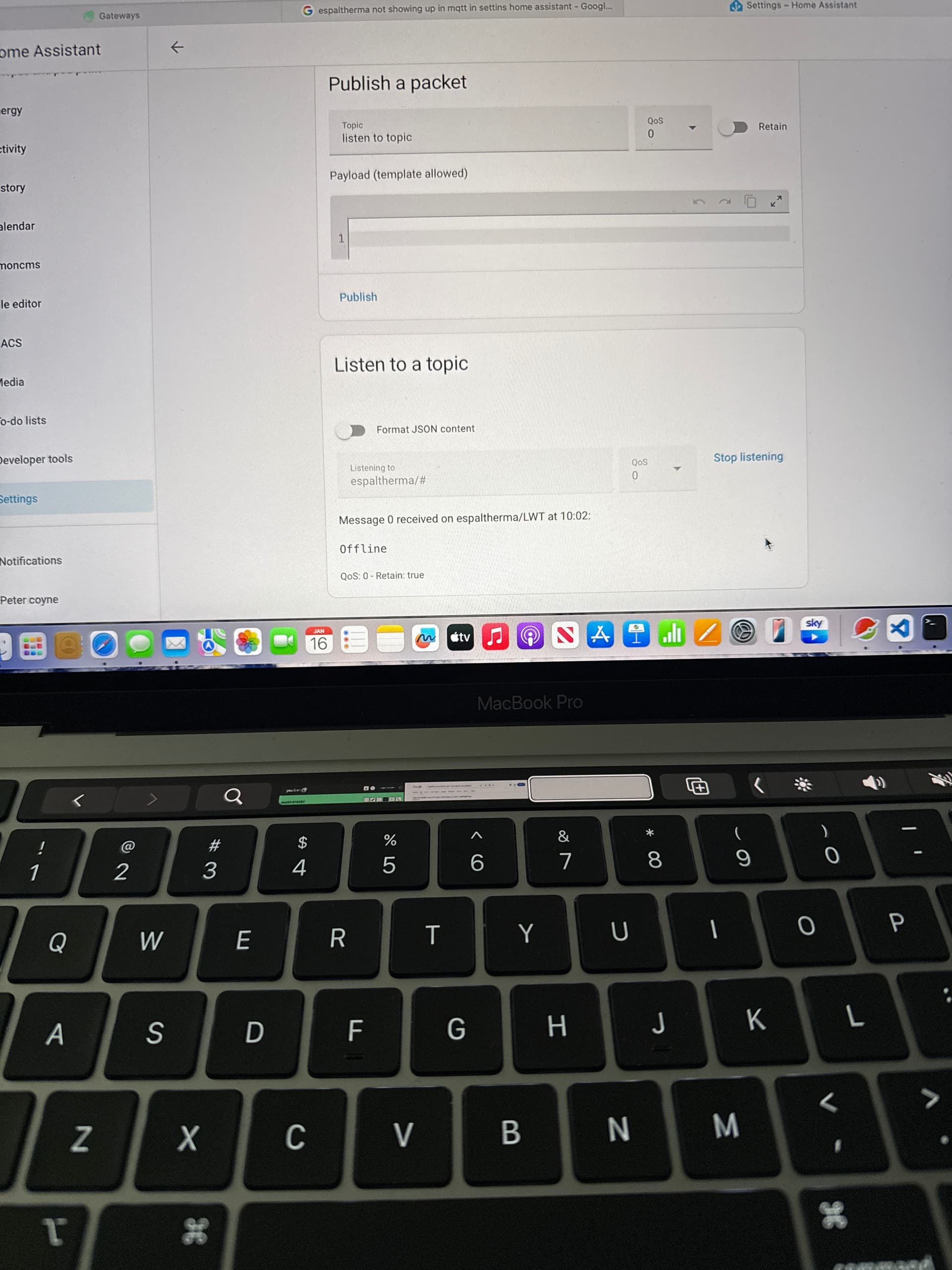

No, at least I’ve never seen mine do that. So now it’s pinging, is HA receiving anything via MQTT?
Home Assistant > Integrations > MQTT > settings cog > Listen to topic
espaltherma/#
Start Listening
basically says offline and message received 0
How long did you listen for?

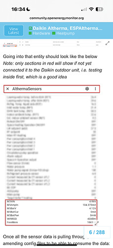

Hi the chip is currently disconnected from my heat pump and is powered from usb on laptop, I remember doing this when I first set it up I was able to see WiFi signal strength etc but not heat pump I/o. I brought it in to see if new router was having g signal strength issues
Ah ok. So when you put it back in the outdoor unit, check the signal strength/ping etc - make sure the WiFi side is good.
The problem is last time I had it connected to laptop once the code was downloaded I would at least see the WiFi strength etc but this time I am seeing nothing so I still think some issues with network setting

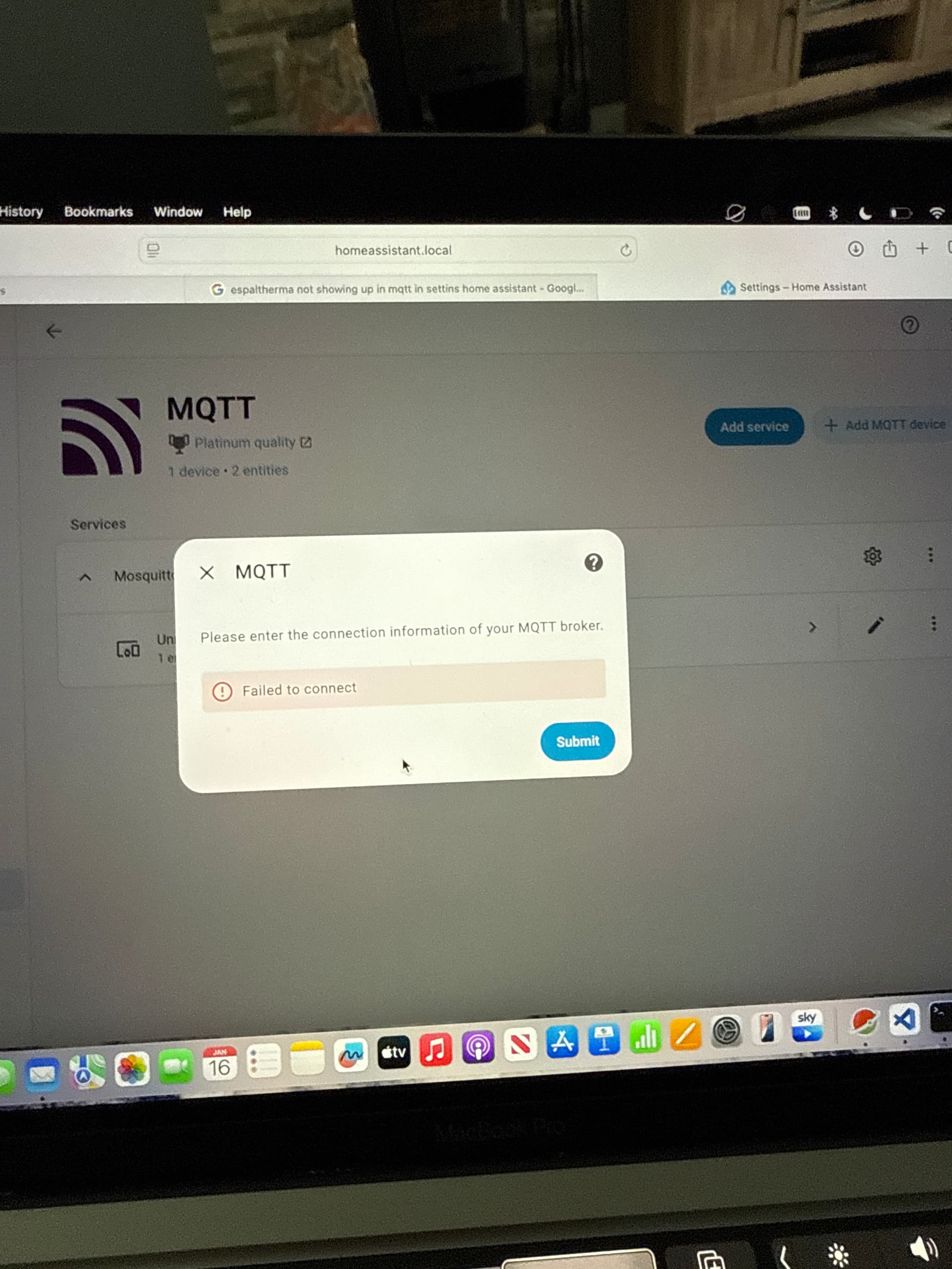

So connected back up to heat pump and issue is exactly the same, I can ping the device from terminal in Mac but espaltherma shows unavailable in Mqtt page in setting and listening shows message 0 received on espaltherma , offline

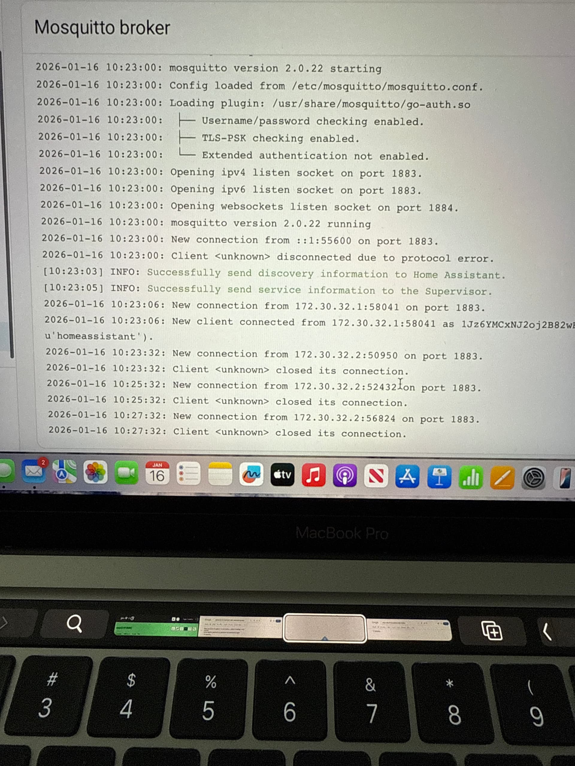

Not sure why Matt broker is seeing this up address

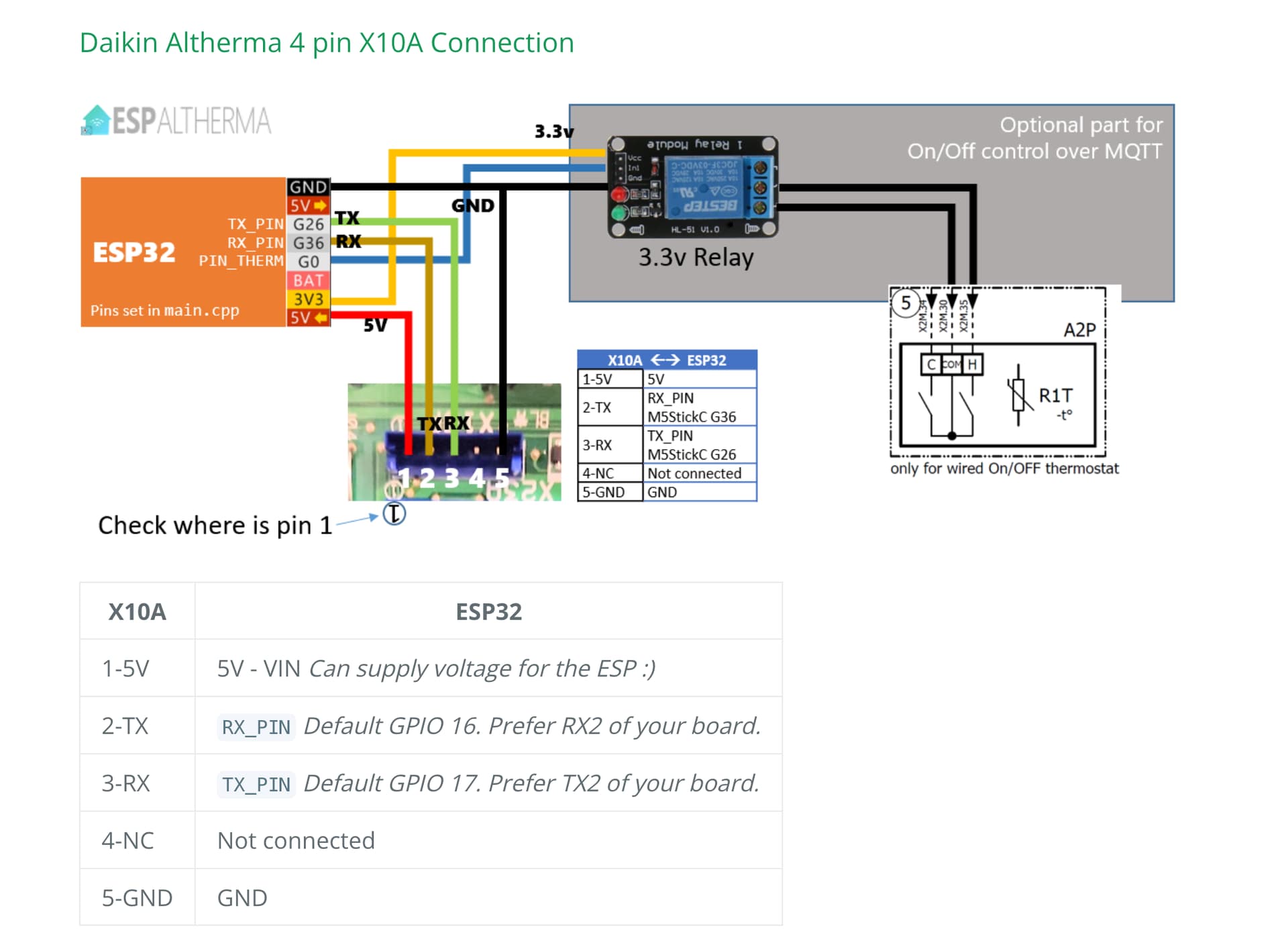

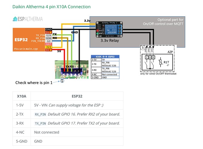

Might be worth double checking the G26 and G36 pins are connected and the right way round.
Hi the ip assigned by the router is 192.168.1.29.
I’ve checked the wiring twice and is ok unfortunately.
So when it wasn’t connected I should see this as per below when the esp is powered but I don’t even see the WiFi strength as per picture below.

Hi this is resolved now, I had to re flash esp32 with the mqtt server address of my home assistant. When the new wifi was installed the home assistant had taken a new ip address. So I have changed to the ip address that home assistant is using in the setup source file for mgtt server settings and uploaded the code with platformio. All working ok again.
