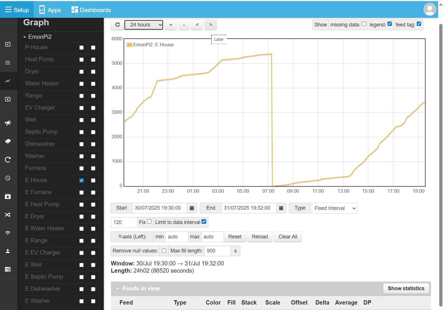

I lost power on my emonPi2. Once restored, it seemed that all the Energy Logs, but not the power logs, were set to zero. Is that data gone forever?
Which brings up a question, “Can I log directly to my NAS which I have mounted in the user directory?” Is this even a good idea? Can I log to two places simultaneously?

Are you referring to the energy values coming from the “emon” part of the emonPi2 and displayed on the Inputs page, or the values you’ve Logged to a Feed - or haven’t you done that? If you haven’t, then it does indeed look like bad news and that data is lost, because a couple of days ago I was looking at the modifications that had been done to my emonEProm library and it no longer works as intended and as described in the documentation. What you need to do to minimise the possibility of future data loss is log those 6 (or 12) values to Feeds. Of course, this won’t protect you from an SD Card failure.

The values I’ve logged to a Feed. I think you implied that the data may still exist, but where is it?

When I did this, all of the energy data feeds were again set to zero. The old data is still there.
the data starts over at zero. Is that the way it’s suppose to work?
What’s “it”? If you mean the original EEProm library - no, as I explained above. If you mean emonCMS, yes absolutely.
Have you looked at Wh Accumulator and kWh Accumulator process steps?
