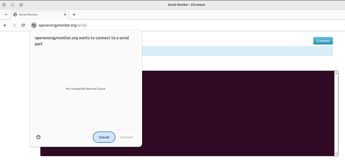

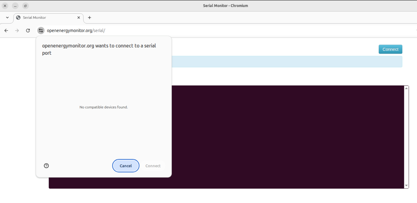

Using Firefox, nothing happens, not even when I click “Connect”.
Using Chromium, I click “Connect” and then nothing happens, with “No compatible devices found”.

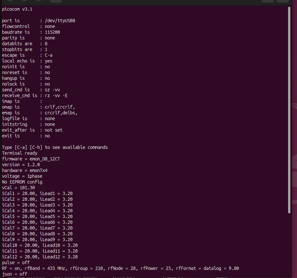

Running Picocom from the terminal with
picocom /dev/ttyUSB0 --echo --baud 115200 --omap crcrlf,crlf
I get comms as usual, and can send the configuration commands, and get reponses.

Yep coms working fine through picocom, connected to serial and receiving messages.

Ubuntu 24.04.2 LTS, and it doesn’t work to an emonTx4 for me with either Chromium or Firefox.

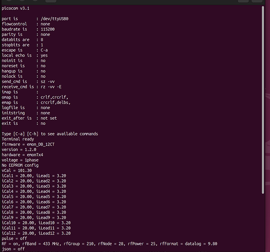

Same cable, same USB port, Picocom stopped, and Chromium does this
Picocom does this:
