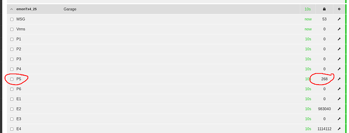

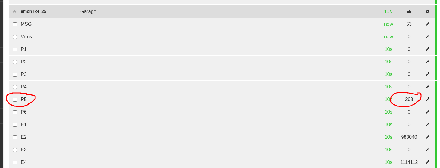

What should be the input mapping of the EmonTx5 modules? I was assuming 1 to 1.
Here I have a single CT attached to input labelled 10 on the EmonTx5 unit. No other CTs attached.
However its showing up in Emonhub seemingly as input 5 on the expansion board (second node id). I would have expected this input to be 4 i.e. 6 inputs for main board then 4th input on expansion board.
Also weird things happening with energy use on E2 and E4 if anyone can guess at the root cause there.

The blocks that begin [[28]] & [[29]] should be in your emonhub.conf file and it’s in emonHub that the binary data is split and allocated names like “MSG”, “Vrms1”, etc.
If you don’t have those two blocks, this is where your problem is - and it looks to me as if this explains E2 and E4 - because those variables are each getting the wrong 4 bytes of data (this is what datacodes = ... does).

Yes, as you saw, figured out the ID and two blocks for the original and expansion board, but across both boards, there’s only a single CT currently connected - CT 10 on the back of the EmonTx5.
Just for the purposes of clarity I’ve got 3 EmonTx5s, 27+28 (expansion, 29 (no expansion) and the EmonTx5 in question is currently set to 24 and 25.
RE emonHub, I’m using autoconfig as set by default. Its detecting them as EmonTx4s but from what you’ve said before, I’m assuming this is close enough. The below is the relevant block:

As I write this I’m realising this looks quite different from the other expanded EmonTx5. Why I don’t know, Ive not manually edited any of these configs. The other expanded EmonTx5 is below:

So I’m assuming then if I redo 24 and 25 to align with the config for 28 and 29…magic magic…problem solved?
…seems to have, thanks!
As a first guess, I’d pin the blame on autoconfig.
So you’re in business and away now. :+1:
