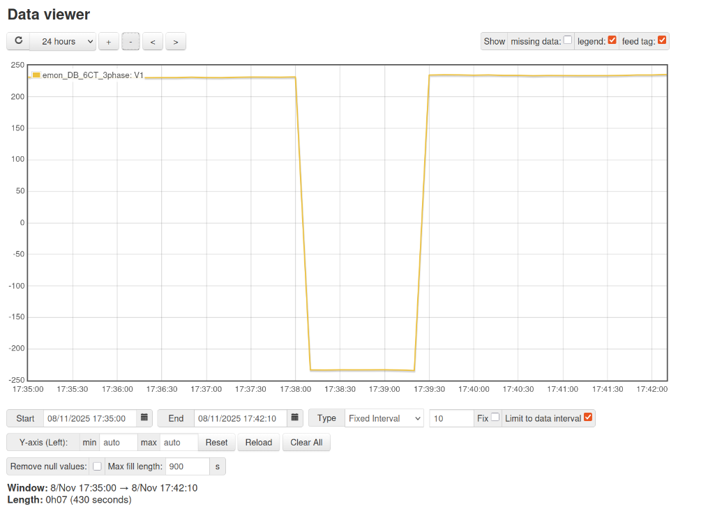

EmonTx4's unstable behavior
That is, the numbers read “V1”:-180.00,“V2”:0.00,“V3”:0.00 or something like that?
Exactly !

See new (wrong) log with frequency:
[08:53:23.164][I][emontx:147]: Received data: {"MSG":12,"F":50.31,"V1":-162.08,"V2":0.00,"V3":0.00,"P1":0,"P2":0,"P3":0,"P4":0,"P5":0,"P6":0,"E1":0,"E2":0,"E3":0,"E4":0,"E5":0,"E6":0}
[08:53:32.997][I][emontx:147]: Received data: {"MSG":13,"F":50.31,"V1":262.56,"V2":0.00,"V3":0.00,"P1":0,"P2":0,"P3":0,"P4":0,"P5":0,"P6":0,"E1":0,"E2":0,"E3":0,"E4":0,"E5":0,"E6":0}
[08:53:42.826][I][emontx:147]: Received data: {"MSG":14,"F":50.29,"V1":-62.88,"V2":0.00,"V3":0.00,"P1":0,"P2":0,"P3":0,"P4":0,"P5":0,"P6":0,"E1":0,"E2":0,"E3":0,"E4":0,"E5":0,"E6":0}
[08:53:52.627][I][emontx:147]: Received data: {"MSG":15,"F":50.30,"V1":-276.64,"V2":0.00,"V3":0.00,"P1":0,"P2":0,"P3":0,"P4":0,"P5":0,"P6":0,"E1":0,"E2":0,"E3":0,"E4":0,"E5":0,"E6":0}
[08:54:02.459][I][emontx:147]: Received data: {"MSG":16,"F":50.19,"V1":-126.24,"V2":0.00,"V3":0.00,"P1":0,"P2":0,"P3":0,"P4":0,"P5":0,"P6":0,"E1":0,"E2":0,"E3":0,"E4":0,"E5":0,"E6":0}
[08:54:12.282][I][emontx:147]: Received data: {"MSG":17,"F":50.39,"V1":51.68,"V2":0.00,"V3":0.00,"P1":0,"P2":0,"P3":0,"P4":0,"P5":0,"P6":0,"E1":0,"E2":0,"E3":0,"E4":0,"E5":0,"E6":0}
[08:54:22.105][I][emontx:147]: Received data: {"MSG":18,"F":50.19,"V1":197.76,"V2":0.00,"V3":0.00,"P1":0,"P2":0,"P3":0,"P4":0,"P5":0,"P6":0,"E1":0,"E2":0,"E3":0,"E4":0,"E5":0,"E6":0}
As you can see in the log, the voltage values are complete garbage !

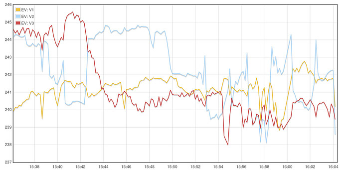

Here’s data from an emonPi3 running the latest 3 phase sketch in our office building:
Could there be a hardware fault on @FredM67’s emonTx4 that’s causing an issue perhaps with the clock that’s then disrupting the ISR timing. I’ve experienced strange things with adding/removing serial prints before and I think they related to disrupting ISR timing.
I do have a spare EmonTx4 on my desk, perhaps I send you that as well as the emonPi3 @FredM67 ?
That’s something I had considered, but it reports reasonably accurate values for the mains frequency, so it seems unlikely. But given that Fred seems to have ruled out corrupted software, I’d go along with a hardware fault in general. As I wrote earlier, it smells of overflow, which could be a damaged pointer (a stuck bit?) causing a write to the wrong place that happens to be where the voltages are stored.

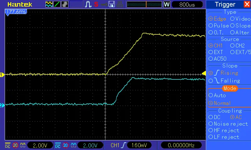

Hi @FredM67 - great you’ve got it working, and also confirmed power up suspicions! You could try checking the reference value for both situations. Potentially the AC/DC converter in the emonVs has longer rise time than USB, but you’d have to put it on a scope to be sure.
Track thickness/length won’t be enough to cause this here - you need surprisingly narrow PCB traces for quite high currents, particularly on the outer layers.
The emonVs 5 V power supply is Multicomp MP-LD10-23B05R2 (10 W @ 5 V = 2 A).
Yellow = 5 V, blue = 3.3 V, load is an emonTx4.0.4 3V+12I

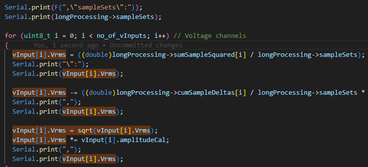

Well, I’m made further “debugging” … it looks like the ADC or something is completely messed up.
I’ve added these lines in EmonLibDB_getReadings:
When the system is running fine, I get every 9.8 seconds this:

Now when the system is broken I get this.
,“sampleSets”:4534":1345881.75,ovf,62314.46":1345881.75,ovf,62314.46":1345881.75,ovf,62314.46":1345881.75,ovf,62314.46":1345881.75,ovf,62314.46":1345881.75,ovf,62314.46":1345881.75,ovf,62314.46":1345881.75,ovf,62314.46":1345881.75,ovf,62314.46":1345881.75,ovf,62314.46":1345881.75,ovf,62314.46":1345881.75,ovf,62314.46":1345881.75,ovf,62314.46":1345881.75,ovf,62314.46":1345881.75,ovf,62314.46":1345881.75,ovf,62314.46":1345881.75,ovf,62314.46":1345881.75,ovf,62314.46":1345881.75,ovf,62314.46":1345881.75
and then
1345881.75,ovf,nan":1339857.75,ovf,nan":1339857.75,ovf,nan":1339857.75,ovf,nan":1339857.75,ovf,nan":1339857.75,ovf,nan":1339857.75,ovf,nan":1339857.75,ovf,nan":1339857.75,ovf,nan"
The key “sampleSets” has been printed only once at the beginning. The “pattern” starting with 1345881.75 has been printed 707 times, all without any single line break, then it changed to 1345881.75,ovf,nan":1339857.75,ovf,nan":1339857.75,ovf,nan": (there was a last 1345881.75then again ovf then nan instead of 62314.46.
reference (printed after the key vrefawas the same for both).
If cumSampleDeltas overflows, then it would point to the ADC running to fast, am I right ?
