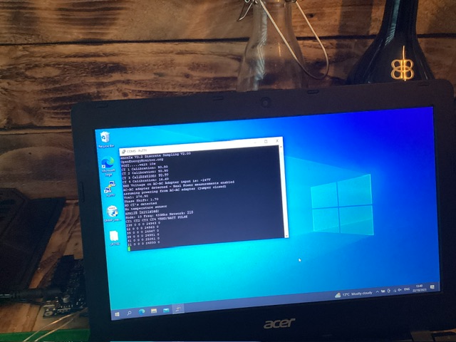

IMG_0020
Sorry for the screen shot, I can connect my esp8266 to my tx3 and connect to the esp by Wi-Fi but no ct ports show up and it does say connected and will show up in emoncms [local] but stay red. So the screen shot is by the usb to aura programmer connected just to my tx3 and putty showing the node and ct ports.Am I being dull or is there a dark art I must learn. I also wanted to upload cm software too, can I do that by putty?
I can’t read your screenshot, but it looks as if it’s output from your emonTx V3 intended for human viewing, not for ingestion and transmission by the ESP8266 to emonCMS. It’s showed up in emonCMS because the ESP has sent that output, it’s got it and seen it, but it can’t make sense of it, hence no values being updated.
There are indeed many dark arts. :face_with_hand_over_mouth:
I’ve looked back up the thread and I can’t see a mention of which sketch you’re using, so what follows is general.
The ESP8266 (or emonESP) expects the output to be in comma-separated pairs of KEY:value format as produced by this code:

which via the programmer will show on-screen something like
MSG:432,Vrms:238.65,P1:540,P2:8
It’s likely you will have a software switch in the code to enable a block that has statements like these. If you have, enable it (uncomment / define it) and ideally disable the radio transmissions too. It might be labelled EMONESP.
