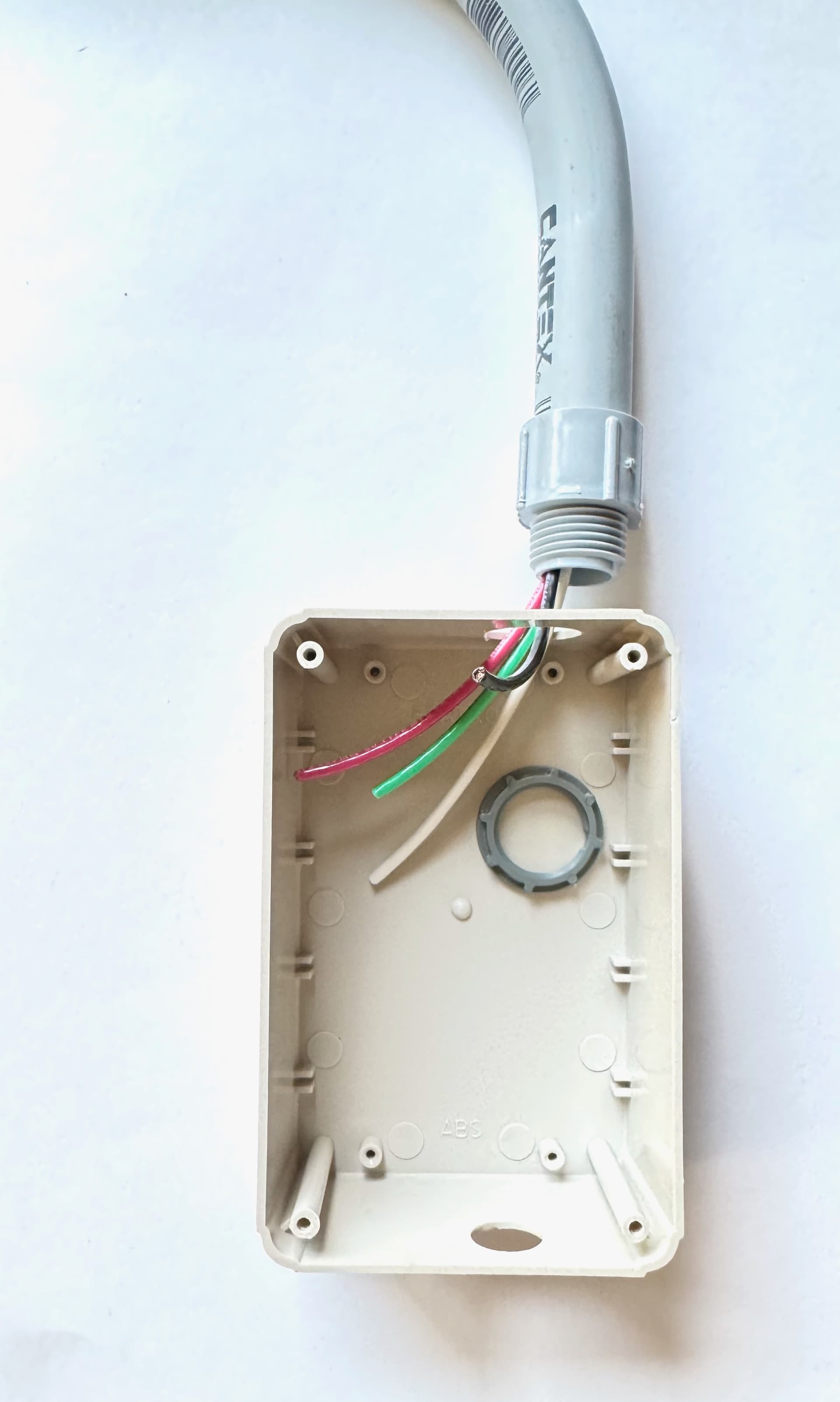

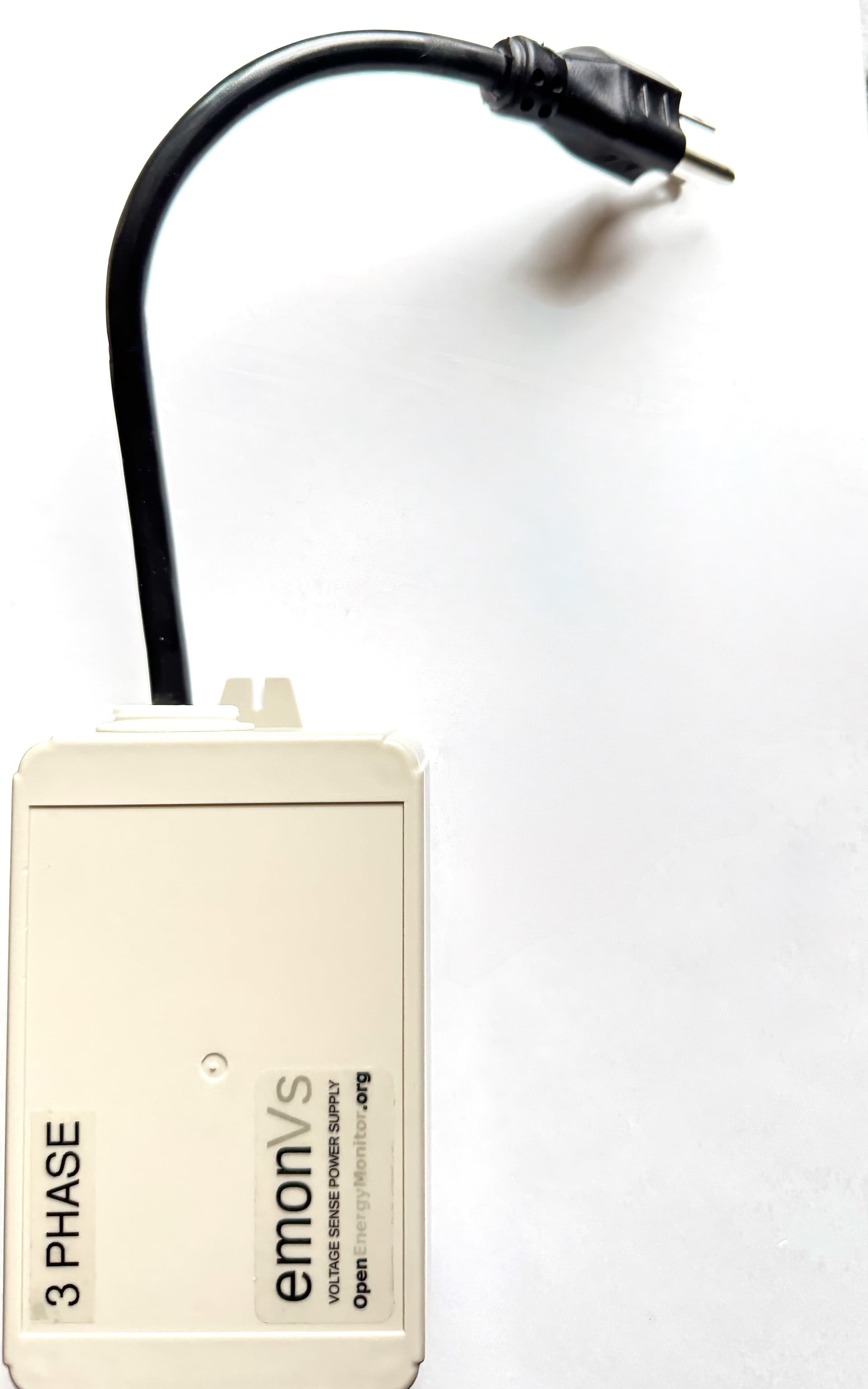

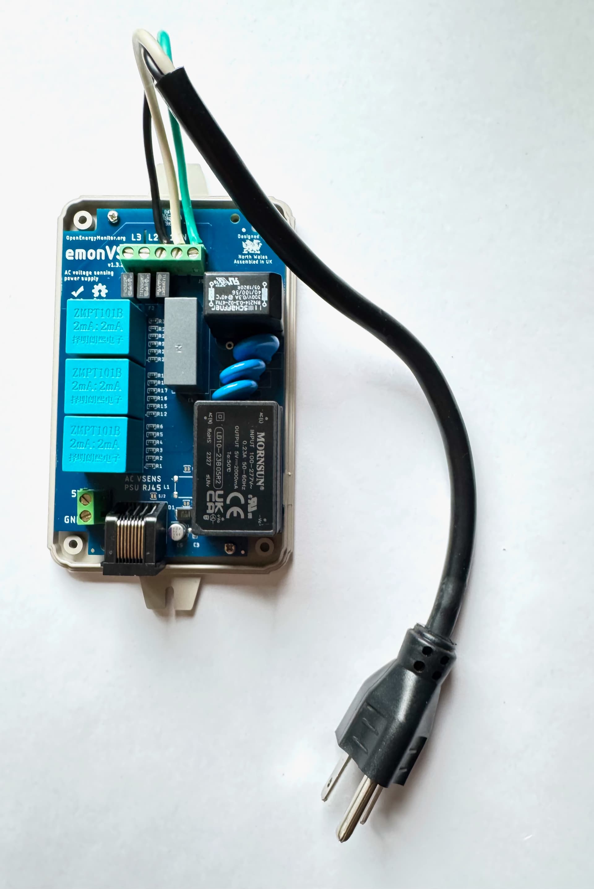

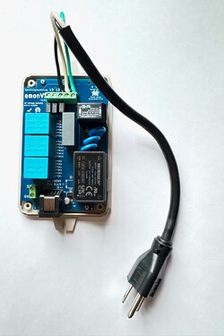

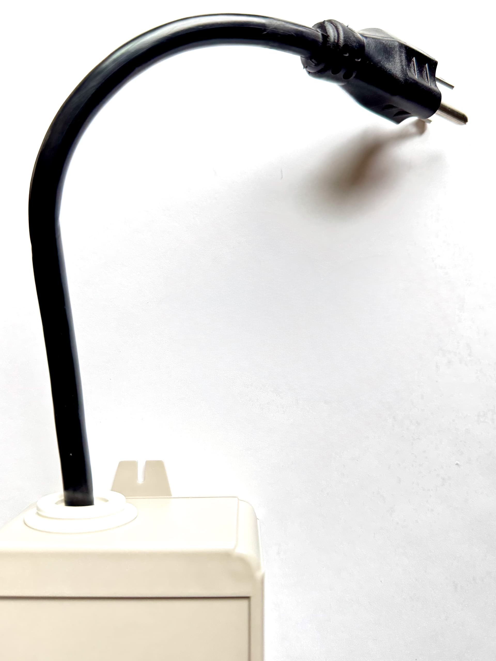

I have had a chance to try out some of the suggestions above regarding how to install the emonVS beside North American service panels.

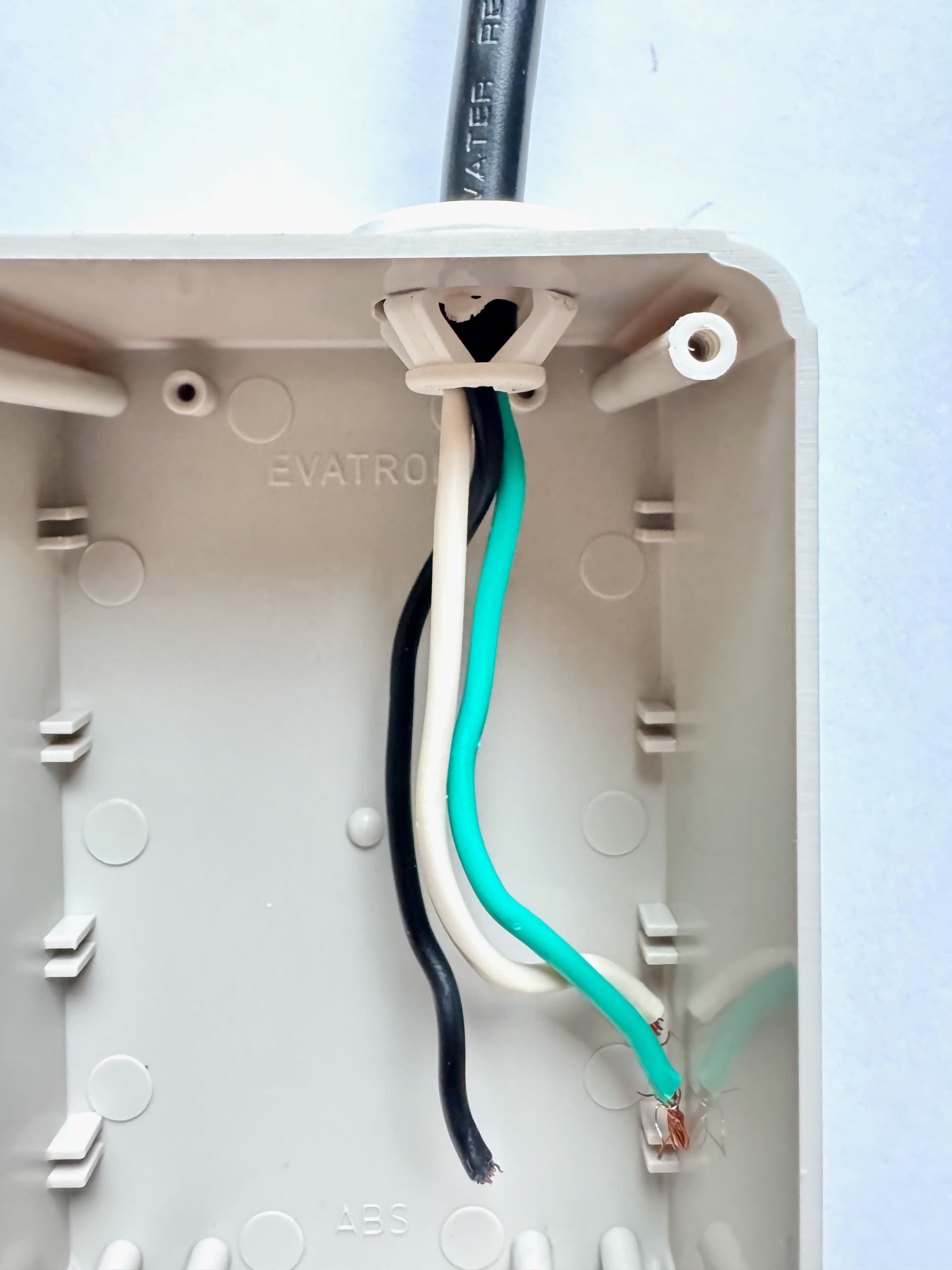

First, here is the New/Non-Technical User that might want to use a NEMA 5-15P cable for simplicity, despite the error introduced by monitoring only one leg.

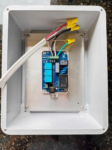

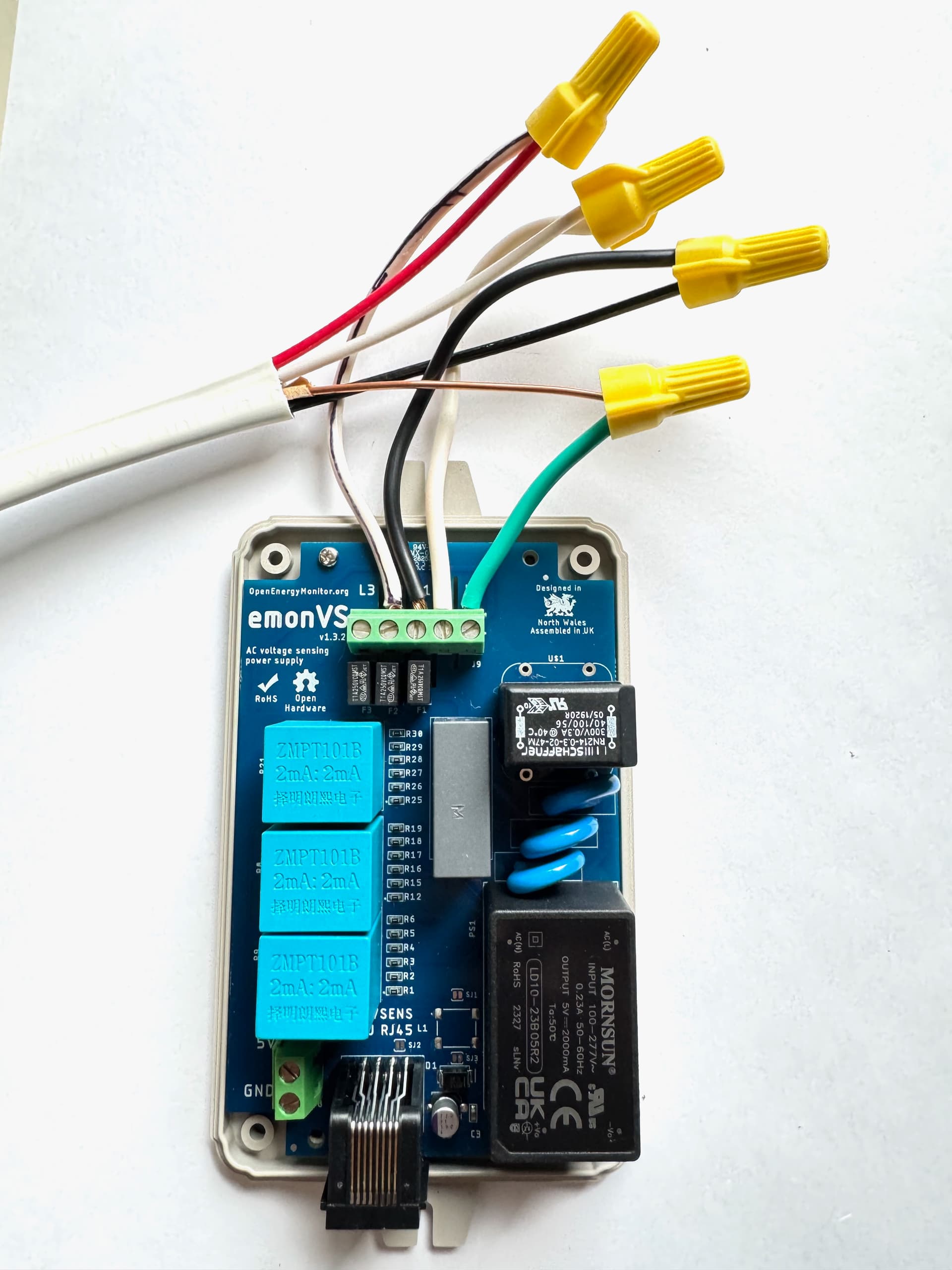

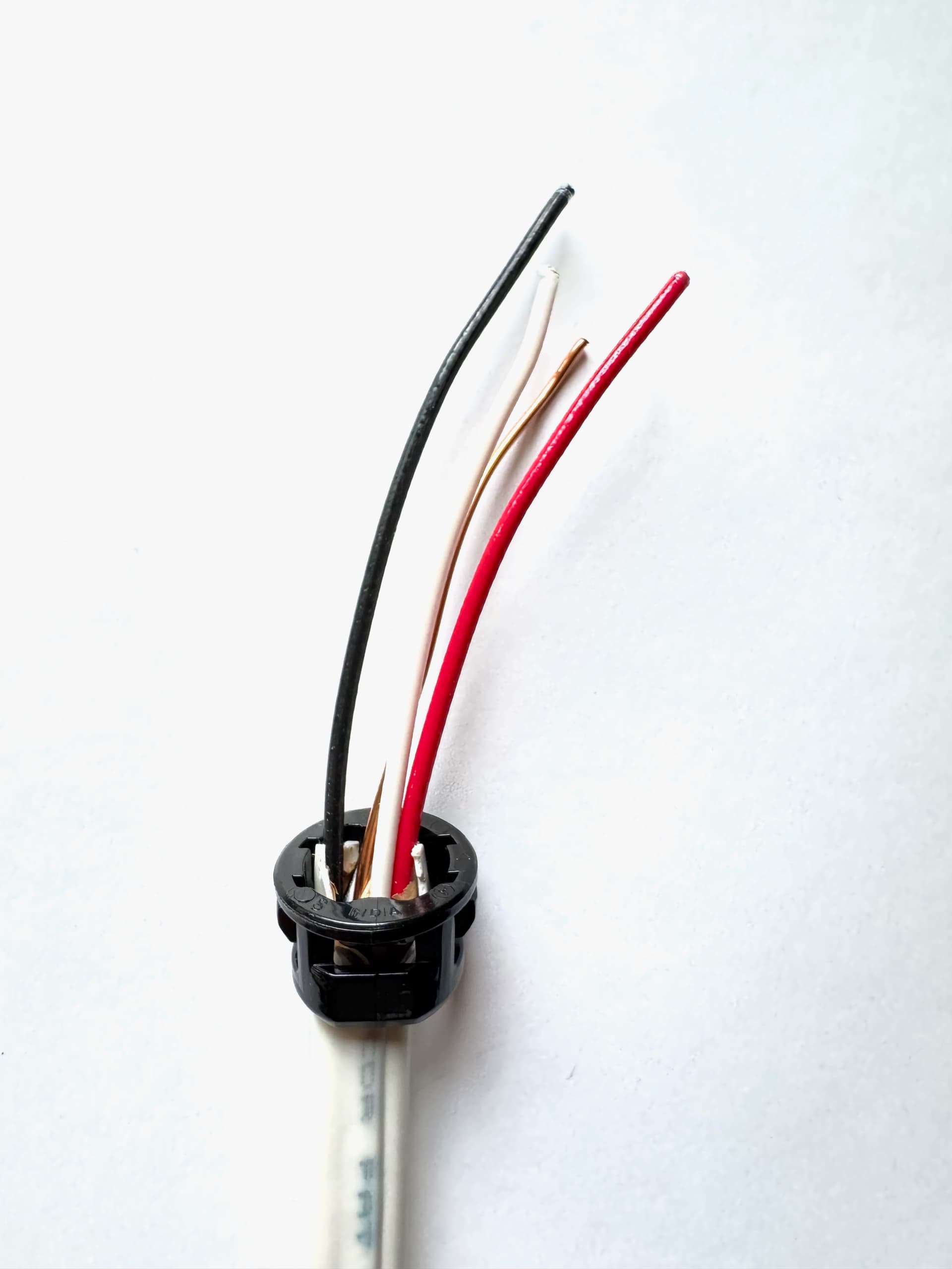

Next, some options we’ve discussed for the Experienced/Technically-Inclined User. Here is Romex 14-3 with pigtails running into the emonVS. This option cost me about $70US at a local hardware store, with most of the cost being the Romex. The convenience is not needing conduit, as I understand it.

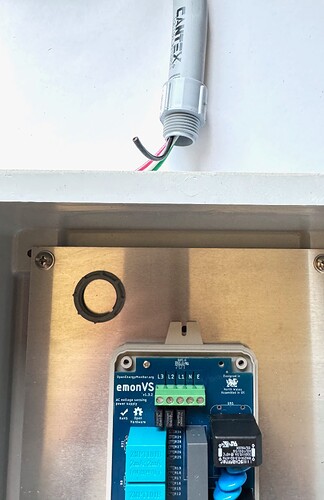

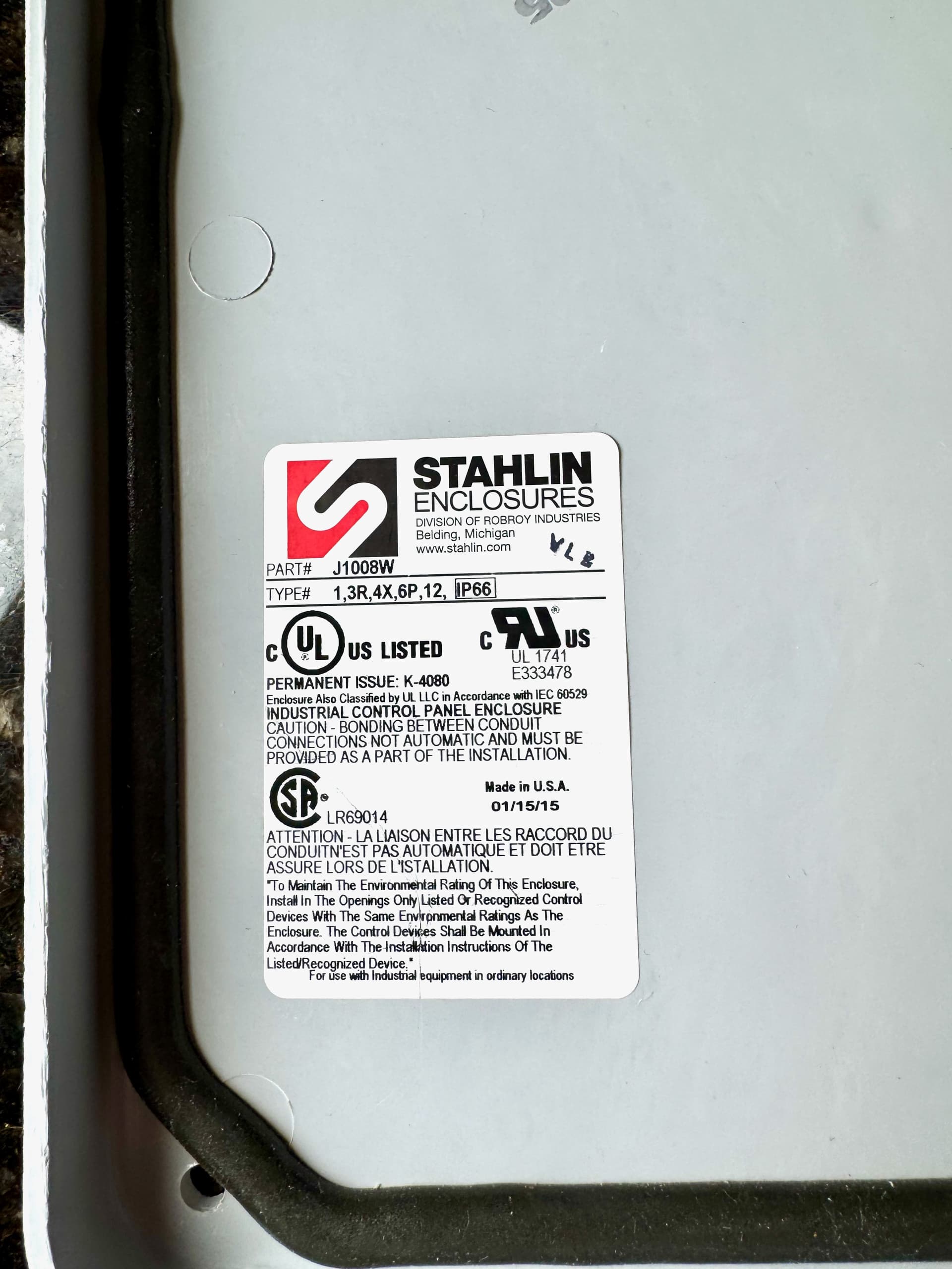

We discussed that the emonVS itself might need to be in an enclosure. Here is a Stahlin enclosure and some pictures of the way the Romex would be enter the service panel and the enclosure through NM clamp (here 3/8" clamps are shown, which use a 1/2" knockout). This enclosure costs about $123US.

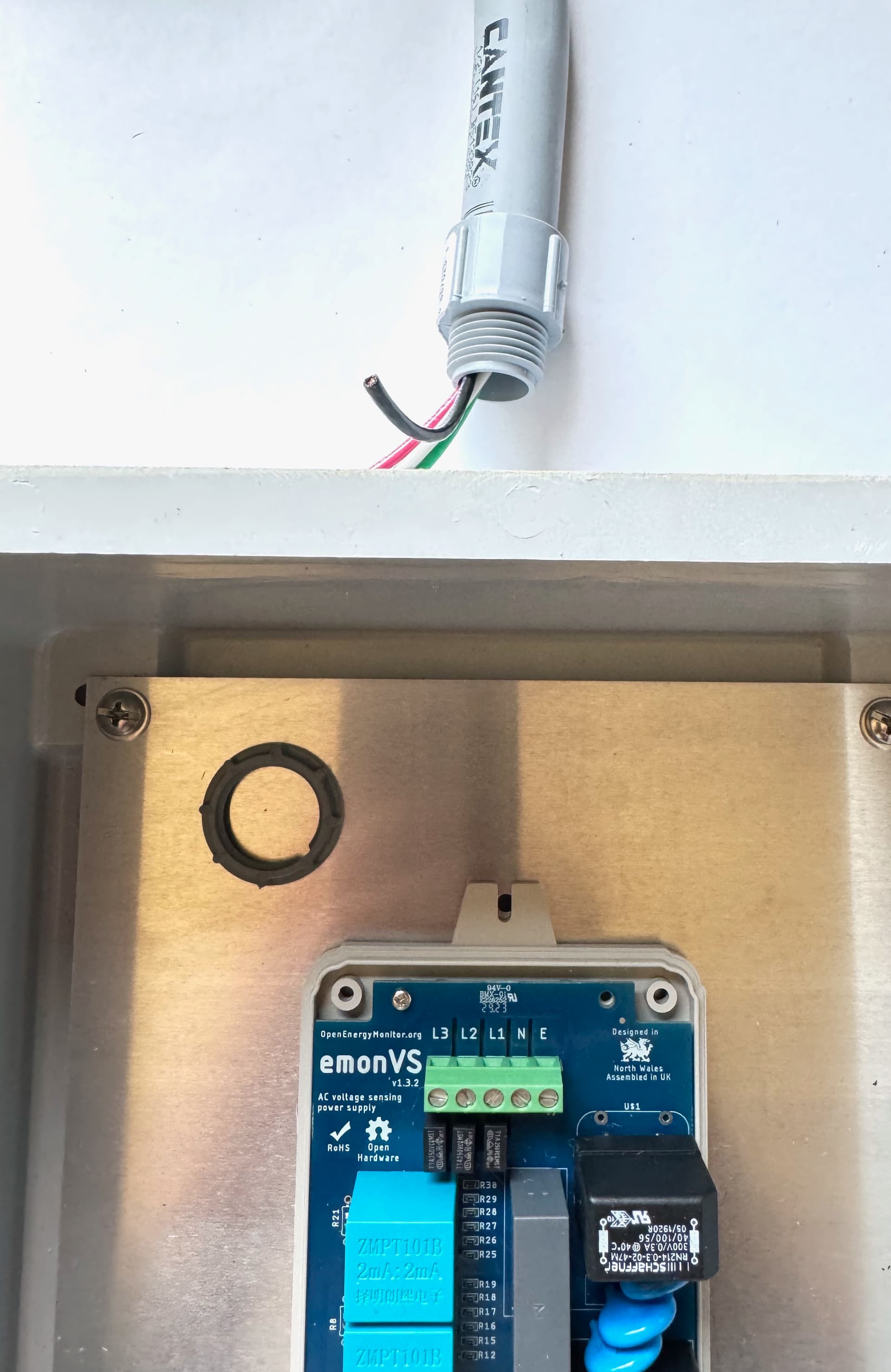

Next here is THHN wire with conduit. This option cost about $15US at a local hardware store, with most of the cost being the conduit. The first photo shows that the emonVS knockout could probably be widened to accommodate the conduit (this is 1/2" Cantex in the photo). If the emonVS enclosure was considered sufficient with conduit, it could potentially work.
Finally, here is an image showing how the conduit would run to the Stahlin enclosure, be secured by the locking nut, and the THHN wire could then be run directly into the emonVS within the enclosure, or to pigtails, depending on the stiffness of the THHN wire.
This is where national standards and practice diverge. In the UK, those thimbles on twisted wires (IMG_5005) are a definite no-no, a screw connector, a crimp or a lever connector (e.g. https://www.screwfix.com/p/wago-221-413-32a-3-way-lever-connectors-50-pack/2803r) would be OK, but it would be normal to replace the supplied cable gland with one to suit the cable being used and make the terminations directly into the screw connector on the p.c.b. You’d also need a label on the outside of the emonVs, stating “WARNING Isolate elsewhere before removing this cover” or words to that effect, and it could, but wouldn’t need to, go in another bigger enclosure.
You obviously could not use a fixed conduit because of the location of the fixing screws for the case of the emonVs (and I would say not acceptable because it would prevent inspection and maintenance of the emonVs), but flexible conduit would be acceptable.
