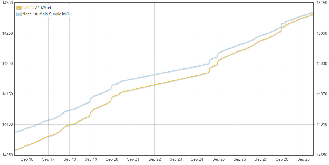

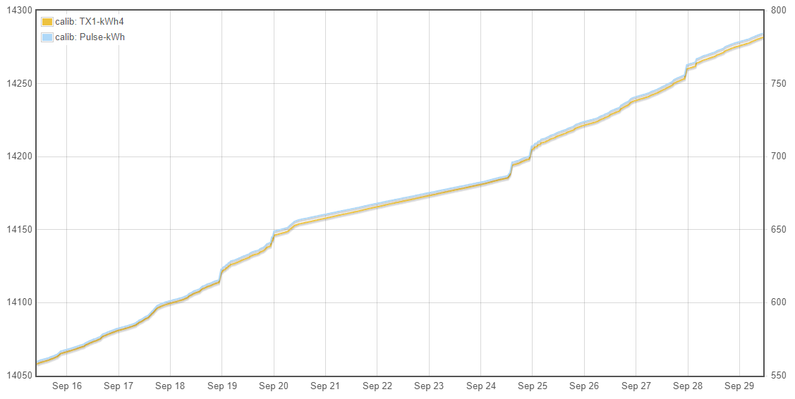

When I installed a pulse meter it was clear to me that my emonTX3 was not that accurate. I ended up putting a scaling factor of 0.9438 in the input processing and it is now very accurate.
With scaling factor emonTX v Pulse over 2 weeks (1 kWh diff)
emontx raw v scaled (13.3 kWh diff)
