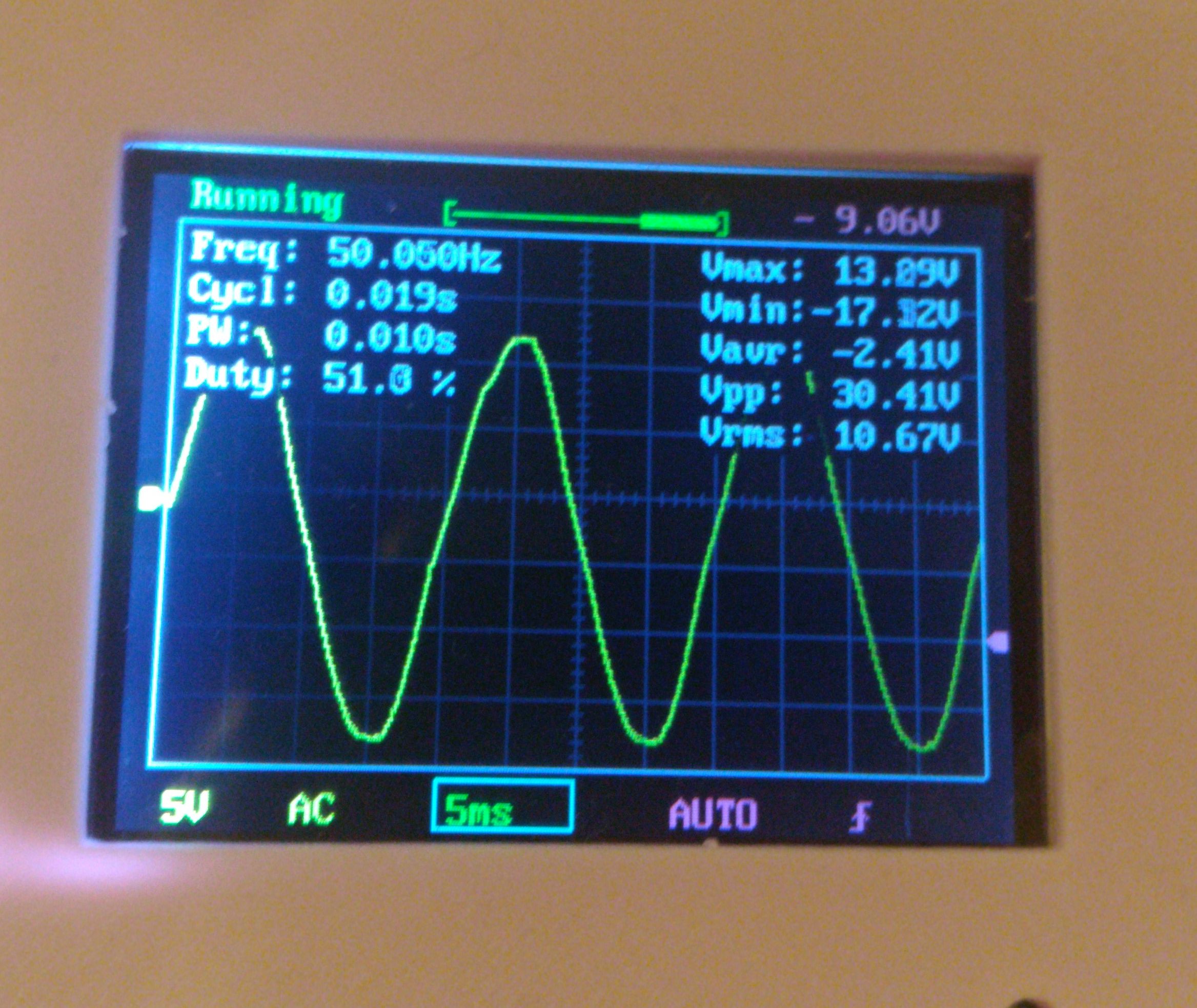

  • No-Name AC-AC Adapter with 10.5Vrms (Says its 9V) and 600mA. A nice sine wave according to my oszilloscope.
  • Emon TX V2.5, Arduino Uno over Serial for debugging, powered over the AC/AC-Adapter with a diode and a 4700uF Capacitor to smooth out the sinewaves.

I tried punching in wild numbers for voltage calibration, all divert to 0. I also looked again at the AC/AC adaptor with my oszi. All fine.

Was that with the c.t connected, or not?
What d.c. voltage do you measure at the voltage input? It should be ~2.5 V.
If you remove that circuit and use the normal Arduino power supply (7 - 12 V?), does the voltage reading still fall to zero?
ok this is strange.
no matter what I do, as soon as I power the Arduino from the AC/AC the measurements go nuts. Either they go to 60V or to 0V depening which phase I connect (so twist wires).
I also build a new PSU, which uses a L7805CV, 2 electrolyte capacitors and 2 ceramic capacitors as well as 2 shottky diodes to prevent current flowing anywhere where I don’t want it.
I also powered the RaspberryPi which I connect to USB for serial readout through a powerbank, so there is no other way the current can flow. I suspected the RPi making a second unwanted sink over the grounded usb wire. The only 2 physical connections the arduino/RPi setup now has are plugs from the AC/AC adapter. The CT’s are just clamp on and the pi is connected via wifi and powererd via powerbank… STRANGE!
If I measure the voltage on VCC and GND it says a steady 5.04V, I also looked at the voltage with my oscilloscope: steady (without the extra 470 uF capacitor I added on the VIN I saw a small sawtooth, the VCC had steady 5V also without the capacitor)
Since I was tired of messing around with saving another 5$ on a Wallplug I installed one and since than it’s running fine. I am now suppling 5V through the screwterminals on the emontx-shield (GND and VCC).
Anyway, I measured the resistance again without the CT’s plugged in. Now it’s 33,3 Ohms. Fine :smiley:
On which pins should the voltage be ~2.5V?
And just out of curiosity: what could have gone wrong?
The AC AC adapter has 800mA, the power is stable in VIN and VCC, I added diodes and ceramic capacitors to get rid of whatever wavy form my oscilloscope could have missed and I also insulated everything from false current sinks.
Clearly, you are doing something wrong, but I cannot tell what that might be from your description. Can you supply a circuit diagram of the arrangement that caused the incorrect readings?
