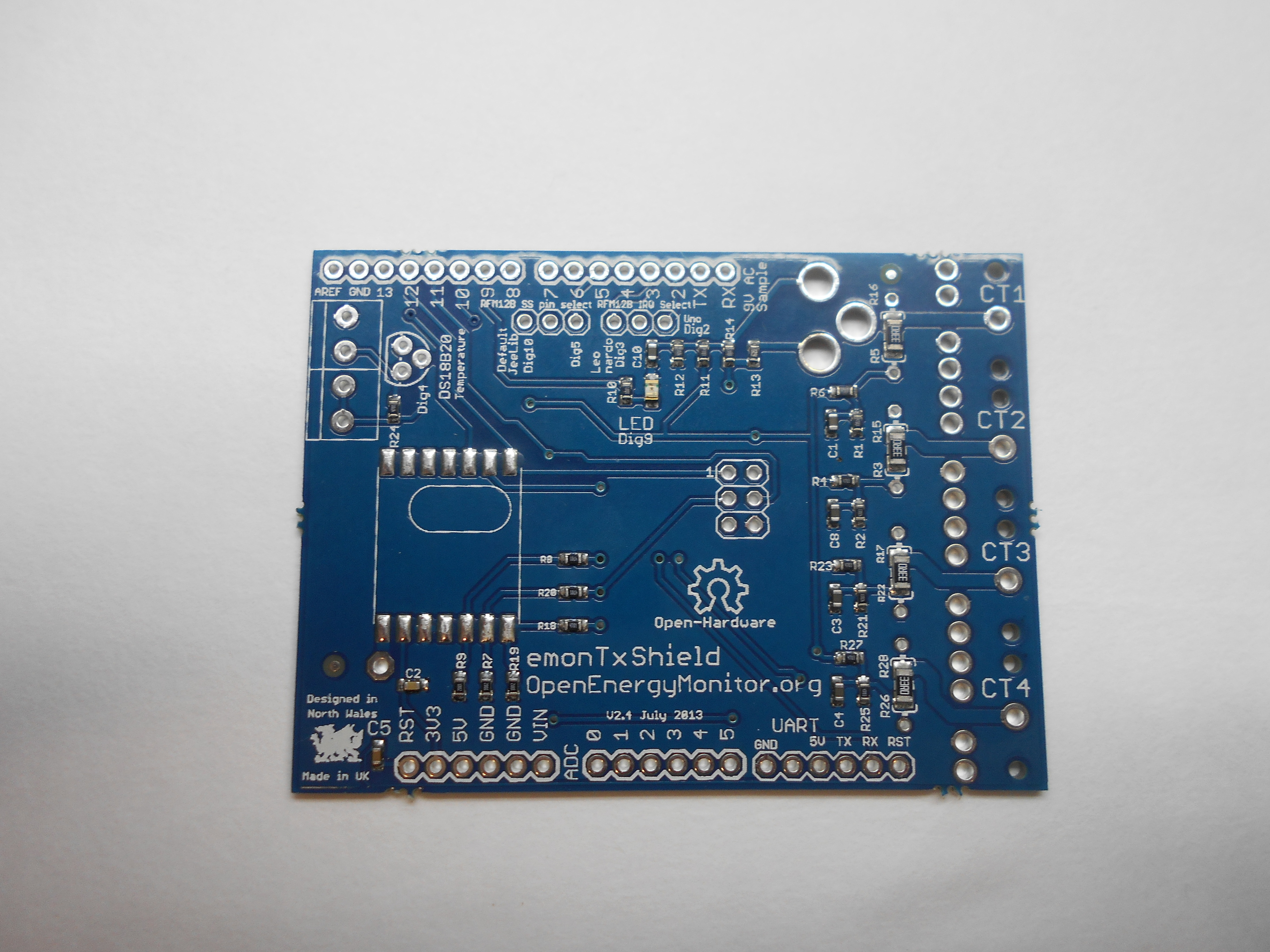

I have an emonTx Shield and emonBase, both with RFM69.
I want to measure current and real power with CT sensors and transmit data via wireless using RFM69 to emonBase
When I use emonTx shield firmware examples from github

At this point if I set to 0, the sketch run well and send data by serial monitor, everything is fine, but I’m not sending data via wireless
If I want to send data with my RF69 I set to 1, but I always get the same error, and it doesn’t send any data by serial monitor, only setup configurations ā€œemonTX Shield CT123 example, OpenEnergyMonitor.orgā€ etc, but no data.
For any reason it gets stuck.

The sketch you link to is the correct one. The sketch sticking usually means the RFM69CW is not responding to the initialise command. And that is usually because of a bad connection to the radio module itself. The jumper settings could be the bad connection you are looking for.
Do not forget your antenna. It is important. Without it, you must not operate the radio at or near full power, otherwise the output stage might be damaged.
I checked the connection and made a better soldering, I think it’s fine, it’s like this image https://wiki.openenergymonitor.org/index.php/File:EmonTx_Shield_top2D.png
But it gets stuck anyway
I dont’ know what happen, maybe my RF69 is defective?

I checked one last time this morning soldering and jumpers and I don’t know why it works, it’s sending data without any error
I think it was a bad connection… Occam’s razor
