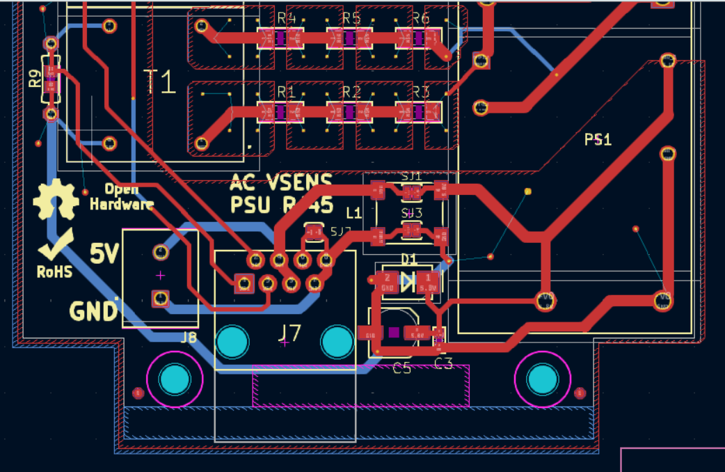

It might well be worth getting a copy of KiCad and importing the Eagle CAD files from Github, so you have the schematic & board layout to hand. (If you can’t figure out how to import them, I can provide a zip version of mine.)

Disconnect from the supply, take the bottom off (depending on its age & version, you might need to unplug the output cable and/or slacken the glands, and look at the end where the output cable is. You’ll find screw terminals labelled 5 V & GND - check the voltage there.
or
If it’s good, skip to checking the cable.
Otherwise, check continuity across both legs of suppressor choke L1 - it’s in circuit on early versions but shorted with cuttable links on the V1.4, and overcurrent can burn it out and put a short on the d.c. converter.
If that’s OK, check the fuse - it’s the very first component after the L1 terminal and the terminals of the Schaffner filter (U$1) are a good place to measure. N is nearest the edge and L nearest the terminals. A ruptured fuse means unsoldering and replacing.
If that’s OK, work your way towards the emonTx, checking the cable - it’s straight pin-pin.
