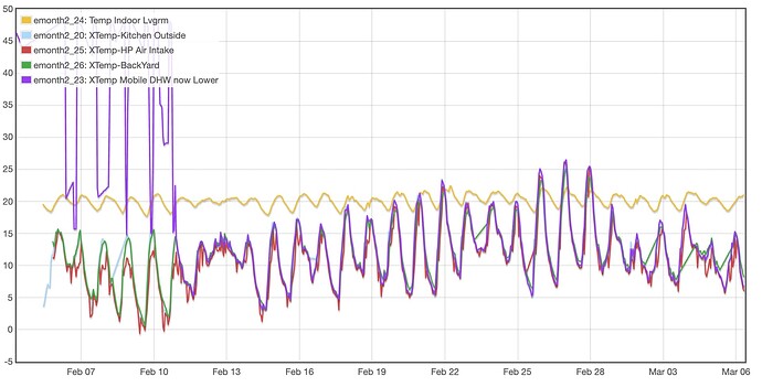

I did notice (I think) that the shield in DS18B20 cable seems not to be connected to anything, ie not connected to base circuit; perhaps(?) it is connected to the metal cap encapsulating the sensor, I didn’t check that. Any other advice is welcome. It’s all frustrating as I need stable temp data for analysis, and weather station data Glyn gets for me is anomalous, and can be easily 3-4deg different from my sensors. Finally, here is 1 month’s worth of temp traces - if you look closely one can see at least 7 fails in this time window (ignore the wild purple data in first week):

Hi @Glen_Garfunkel - just to check, does it completely hang up and require you to come and restart it, or does it just miss some packets?
I need to disconnect and reconnect the battery in the base unit, then all is good. I will try connecting to external voltage source - I haven’t done this only bcs it is rather inconvenient, but at this point I need to.
Sounds like the micro is getting locked up - are the batteries still ok? Might be worth checking with a fresh set. There’s no watchdog running as it does add some power consumption, so there’s not that mechanism to automatically restart.
