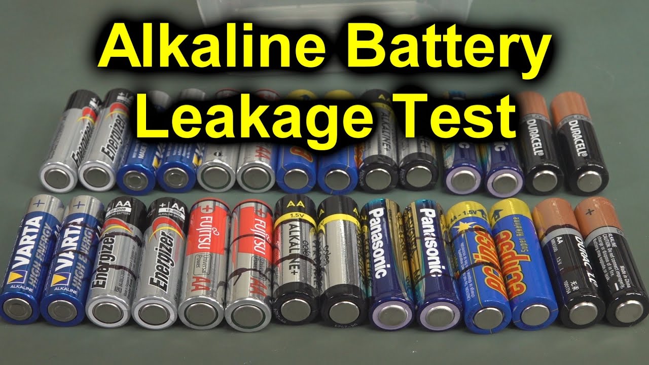

I’ve found both regular Duracell Coppertop and Duracell ProCell to be leakers, even when in date. So much so, as they have similar lifespans to cheaper batteries, it seems pointless paying the extra for them.
YouTuber Dave Jones is running a long term leak test on various brands of Alkaline battery brands to see which are the worst offenders. Should be interesting.
I like Dave. He tells it like it is. thumbsup
