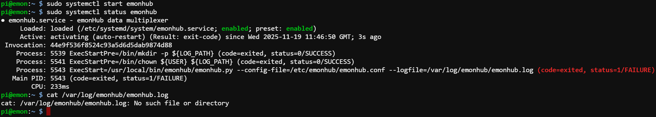

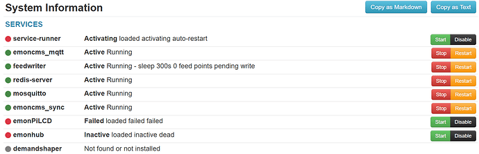

I’m now in the state where OEM is running on the RPi and I can get to the web UI. However… emonhub refuses to start up:
it looks up to date:
and I’ve tried to start it manually:
emonhub is crucial to my installation, as it’s the route in for energy data from the Eastron SDM230.
