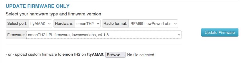

Without connecting a programmer and hoping the device (emonTx V3 & emonTH V?) spits out some useful information at startup (the best), or checking the data packet structure being received in emonHub and then seeing which software versions fit, it’s down to what was the default on the day you bought each device.
I wrote some notes and explanations about the compatibility problems when I published the full suite of software to work with the emonPiCM, but it was never officially adopted and “The Shop” went with the Low Power Labs library. The two r.f. protocols are incompatible so you either update your emonPi and then “downdate” it to use the obsolescent JeeLabs library (and not change your emonTx & emonTH), or you update everything - which you can do by updating your emonPi first and then connect your emonTx & emonTH via a programmer to the USB port on the emonPi and use it to upload the LPL software. If your emonTH has got 3 external sensors connected, then you might need custom software (I think the emonTH sketch loaded in your emonPi after you update it - and certainly the update published today - will only send the data for the first external one it finds unless it’s been changed and we’ve not been told, which is more than likely. I think you’ll need to find the file inside your emonPi, edit and recompile it and then upload to your emonTH).

I don’t know, something similar is sometimes offered when a problem surfaces with a new version of the default software (like today and the emonTH battery problem), but I’ve never seen it offered as a standard service. You’d better ask: [email protected]

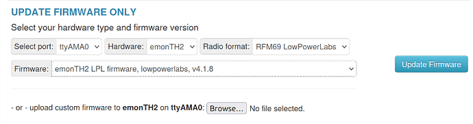

It’s not all that scary, you don’t have to install the Arduino IDE, the software is pre-compiled and exists in the downloaded image, the upload software likewise, and you choose what you upload within emonCMS on the Admin → Update page
(Those settings won’t work - the emonPi is out in the garage, nothing is plugged in and I’m not going out there to do anything :wink:, but that’s about all there is to it.)

That’s not difficult - it’s a change to the compile-time options - just add one line. But until it makes it into the download image, you’ll need to download the new (4.1.8) version GitHub - openenergymonitor/emonth2: emonTH V2 wireless temperature & humidity sensor with SI7021 sensor, and change line 134 to read
#define EXTERNAL_TEMP_SENSORS 4
(and change your emonhub.conf file to suit),
The hard part then is to either copy the file to the correct place in the emonPi and compile it there, or compile it on your machine and then upload the compiled .hex file to somewhere convenient and then use the update tool as per the last line in my screenshot above. Unfortunately, I don’t know where the ‘correct place’ is and as far as I know, it’s not documented anywhere. I’ve never attempted to compile on an emonPi but the instructions are here: emonth2/firmware at master · openenergymonitor/emonth2 · GitHub From this, I assume a compiler is already included in the SD Image.
