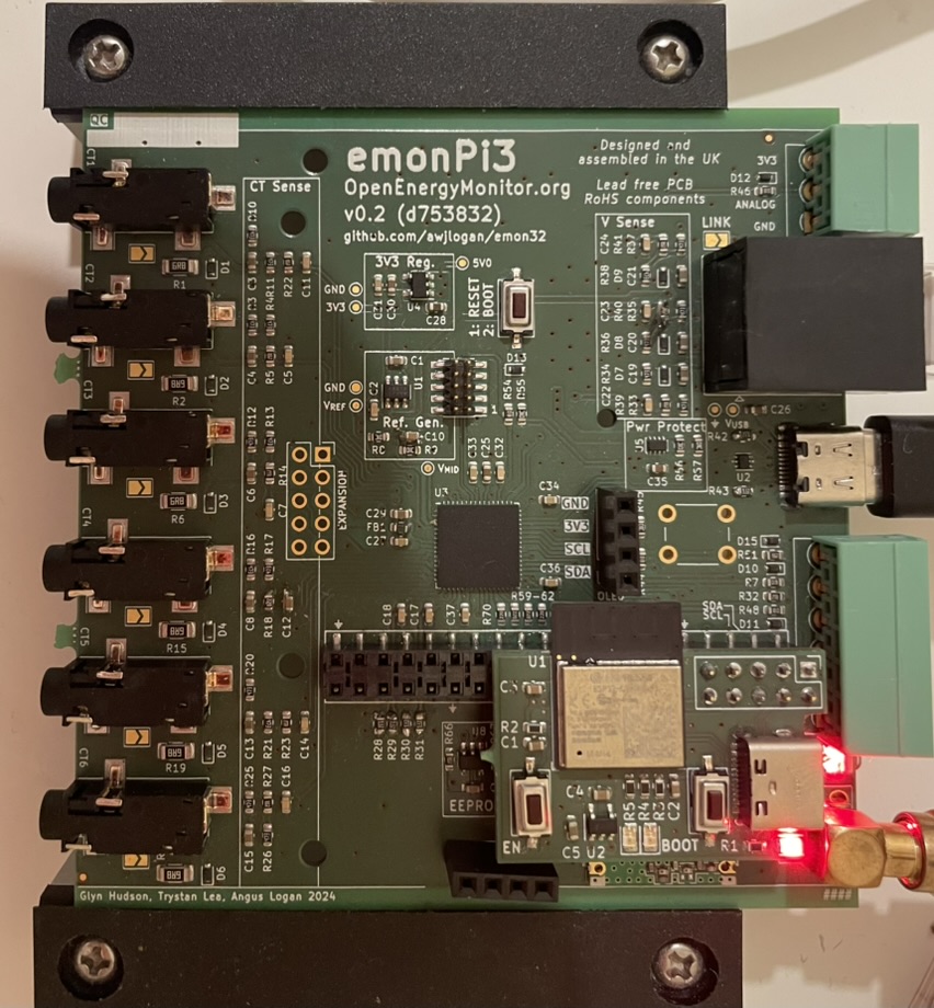

Could one be added? A plastic/3D Printed case would ease that issue.
Not easily - the ESP32 module is available with a U.FL connector in place of the PCB antenna, but that makes the antenna a requirement. It would also require an additional cutout or structure in the front panel to accommodate it.
Cost is a killer when it comes to casing - it’s a relatively big board, so a 3D printed one would be a long print (so not cheap) and anything custom is expensive. When designing things, it should always be case first and fit the PCB and components inside that.

What board is this? I don’t think I’ve heard of it before.
You can find variants with external antenna, at least the version where the pins are on the border.

@Gwil I designed a small add on board which fits the Tx4, Tx5, and upcoming Tx6 - similar to the board linked in the thread below. It’s just a simple ESP32 board with headers, and Fred and Brian did a lot of work on the ESPHome software integration for HA.
Hi Fred - here’s an image of the adaptor board connected to one of the emonPi3 prototypes. [E26FE5EF-FD39-495A-9A11-B6C4DBD15FA7_1_105_c] I don’t know enough about the HA integration side to comment too much on the data that’s available and how it’s parsed. For example, the emonPi3 will always output all the voltage and CT channels, even if they are inactive, as 0 is still a valid value. If the HA integration can filter out values that are known to be unused, that would be best - is that the …

@FredM67 - yes, you can. The 1U variant of the ESP32-C3-Mini I’m using has only a U.FL connector so you must either have a feed through to an external coax socket or an antenna (which doesn’t solve the original issue). Either way, it’s quite a bit more cost and “effort” to include. Anyway, it may not even be a problem so get that testing out the way first ![]()
