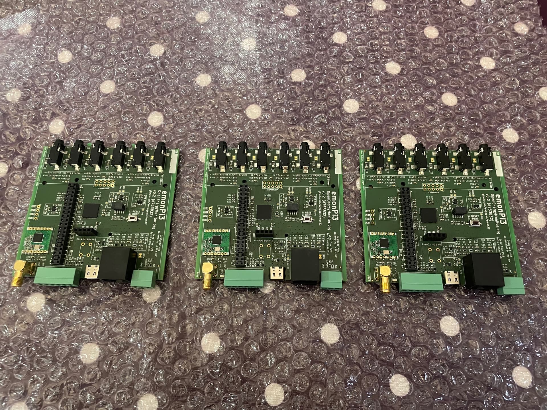

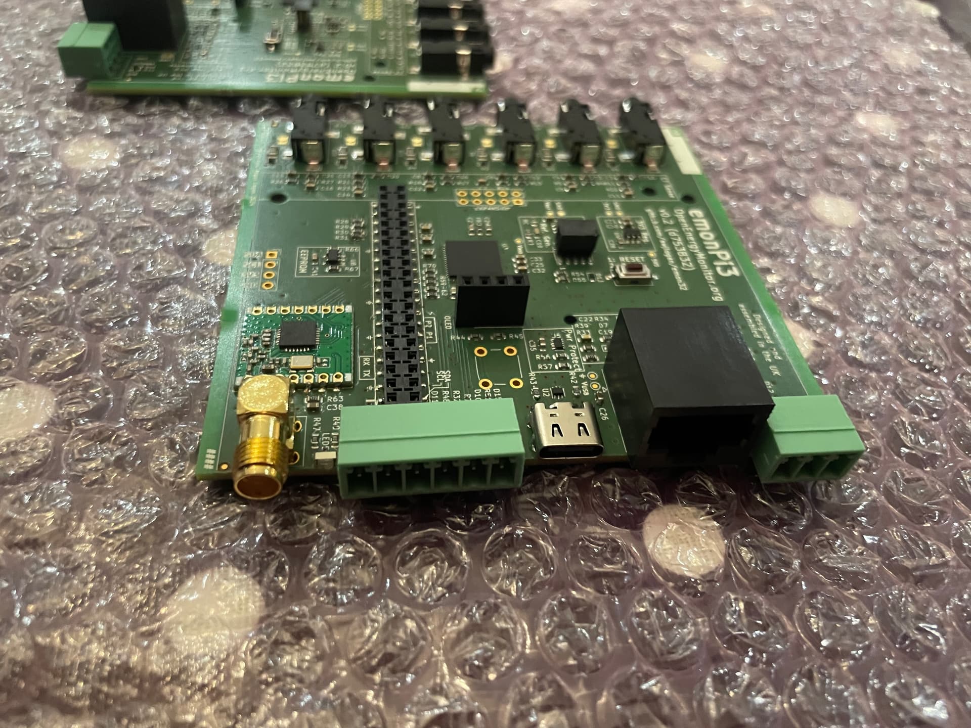

Ok, the v0.2 boards have arrived and work nicely with the USB bootloader uploaded :slight_smile: Three little pigs:
PCB assembly by Aisler - EU based and priced similar to the Chinese shops, and I’ve been very happy with the bare PCBs before. The assembly process was easy, and would definitely recommend using them in future.

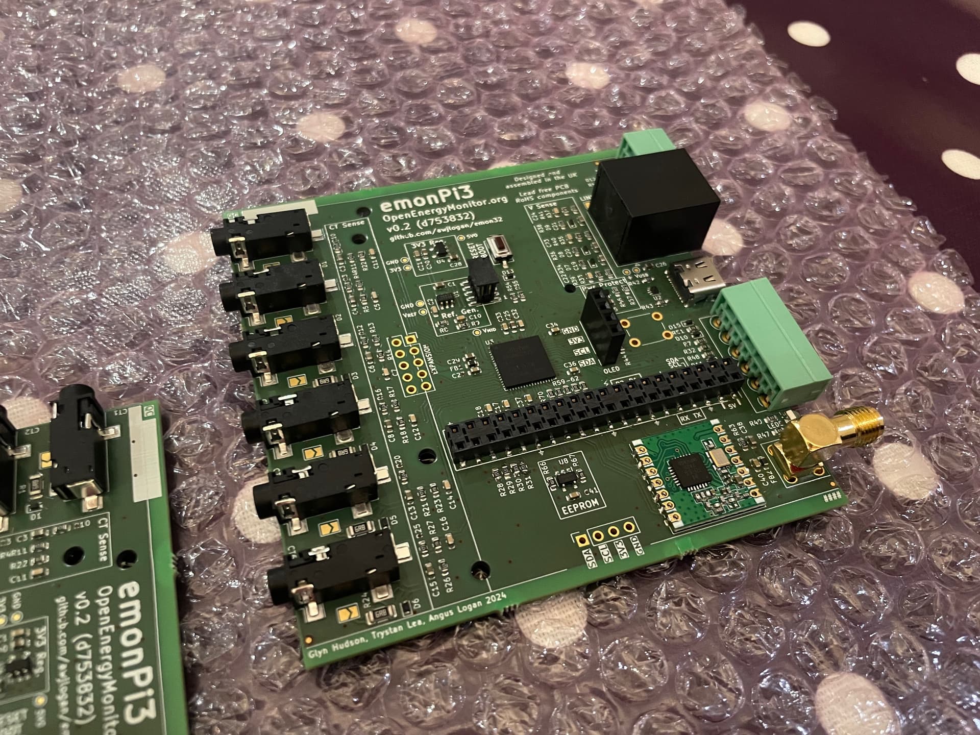

Only one ā€œmajorā€ mistake - the KiCAD footprint for the bicolour LED on the front is incorrect. I’d fixed this for another project, and clearly forgot to port it over to this one. Will open a PR with KiCAD as well, a bit annoying. Not a functional problem, but there’s no visual indication of activity. Good to catch at prototype stage.
Next step: finish off the firmware. Thanks for everyone’s input and comments so far, and always open to any other suggestions.

Great job done so far. I would only suggest to drill ct clamp connectors pads to give them more strength. Correct me if I’m wrong. I was wondering if there is any chance to buy any spare board if someone have any assembled. Posted to Uk address
Kindness
Rob.
Hi Rob - thanks for the interest. The CTs attach through the 3.5 mm jacks, which have 3 large pads so there’s no need for additional support. I’ve revised the expander board to use a two row connector, which provides more mechanical stability along with the screws.

Regarding connectors. Push connectors from WAGO 250 SERIES family gives better look and quicker installation ( talking about green connectors ) but is is only my personal opinion. I’ve had also several issues with plug connectors on my board - sometimes under pressure (tightening)solder can break causing loose connection.
Are u considering adding Can Bus interface like mcp2562 just to be available on board to solder. I.C. for future development. ? This could bring more adoption to your board. Possible expansion where no network is available.
Last one. Could you please explain advantages of making this board 4 layers. Did this reduce space compared to price production increases. ?

Two reasons we will stick with the existing ones, rather than something like the Wago 250. 1) Backwards compatibility with existing installations (e.g. people have their temperature sensors terminated with the correct pin), and 2) the casing dictates the choice of connector; the W 250s look like they need access above the socket to press the button.
This could be placed on the expander header. I don’t have space on the board to include this for CAN, MBUS, RS485 etc but can be put there for the people that need it. This would be useful for, e.g., heat pump monitoring. The only annoyance of using the expander header is that there isn’t a serial module available, so it would have to be bit banged. This may be addressed with another product in the future…
Sure - the extra cost is very low these days, it’s a 20% premium over the 2 layer board with the same tolerances and finish. This board has a lot of signals going into a 64 pin UFN package, and 4 layers makes the routing possible. All analog signals can be next to continuous ground and power can be put into planes. Additionally, the USB signals can be routed as a proper differential pair with reasonable widths (c.f. a 2 layer board!) as well as the (very short) 50R traces for the SPI and antenna signals.

Thanks for update. Willing to order some boards from Jlcpcb. for testing based on your GitHub files. Is there any necessary changes I have to made. Perhaps you could kindly let me know. Please. So far I have noticed you have mentioned issue with on board led - so there is no indication from that point.
Thanks in advance.
Hi Rob - nice! Ok, a few things to note:
  • You should use the pi3-v1.0 branch. That corrects the footprint error for the LED, along with minor changes.
  • If you want the silkscreen to show the revision, run ./generate.py and use the output in the folder ./output-48cee2e.
  • You will need to have a Cortex-M programmer to flash the microcontroller. I use an Atmel ICE, but anything that can flash an ATSAMD21 will be fine (Black Magic probe etc).
  • You will need to populate J10 for programming.
  • If JLC don’t stock the SAMD21J17, you can substitute the SAMD21J18 which is more commonly available. You can’t use the J15 or J16.
Send me a message if you need any other pointers. It’s only been me building it so far, and things should be documented but it’s always easy to forget ā€œassumedā€ knowledge. Are you ok building the firmware as well?
