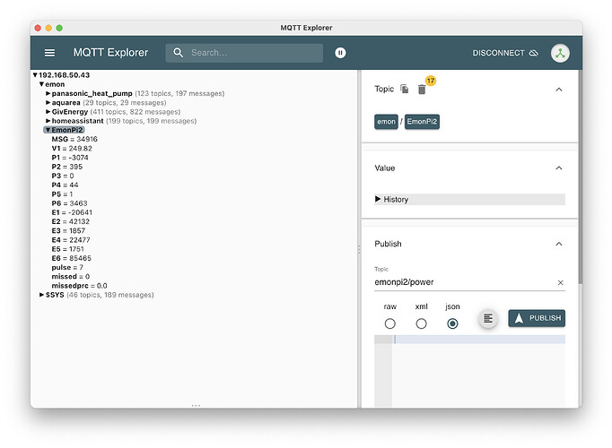

I very much appreciate the help because this is baffling me. Last serial input update now 17 hours ago.
Emonhub log snippet, debug with system not working.
grep mqtt and emoncms_mqtt commands
feedwriter
MQTT explorer. Mosquitto on Home Assistant is configured as a bridge re-transmitting MQTT information from a couple of sensors for the Panasonic ASHP and GivEnergy inverter/battery.
I also changed the emoncms log level to 1 (info) as suggested. Interestingly this shows no MQTT data for the emonpi2 or GivEnergy topics. This tallies with the “inputs” page showing the last update 17 and 15 hours ago respectively for these two topics. MQTT Explorer continues to show refreshes and new data for these topics.
OK, we’re onto something.
emonhub is working just fine and doing as it should.
The values in the log look good, and it’s publishing the emon topic as it should too.
The question is why is emoncms_mqtt.php not doing anything…

the log shows entries from the heat pump… JSON format
Do you see these as inputs being updated ?
I’m guessing yes
Are there no entries at all for other topics… e.g. emonpi2 ?
(FYI the emonhub entries are not published as JSON, but this is more fyi than anything)
Is there any way you can stop everything publishing to mqtt except the emonpi ? You shouldn’t have to restart anything on the emonpi.
[edit] try first without restarting anything, then try restarting emoncms_mqtt.php
(I’m wondering does the JSON decoding interfere with normal operation, but this could be a red herring.)
Yes, the heat pump, aquarea and home assistant inputs all update as expected. The Emonpi2 doesn’t appear at all and GivEnergy only posts a status message (which is also updating).

Thanks for your help with this. I’d noted the MQTT disconnects but thought they were fairly normal.
Rather than bridging everything from the HA broker to the EmonPi broker I’ve selectively re-enabled topics and messages to try and get to the root cause. It does look like an invalid result was received from the heat pump translator, hopefully that’s been resolved.
Since I removed the “homeassistant” topic (and duplicate GivEnergy sensor entities) from the broadcast and all the “raw” topics from GivEnergy and the panasonic_heat_pump topic everything seems to have been stable and updating as it should.
