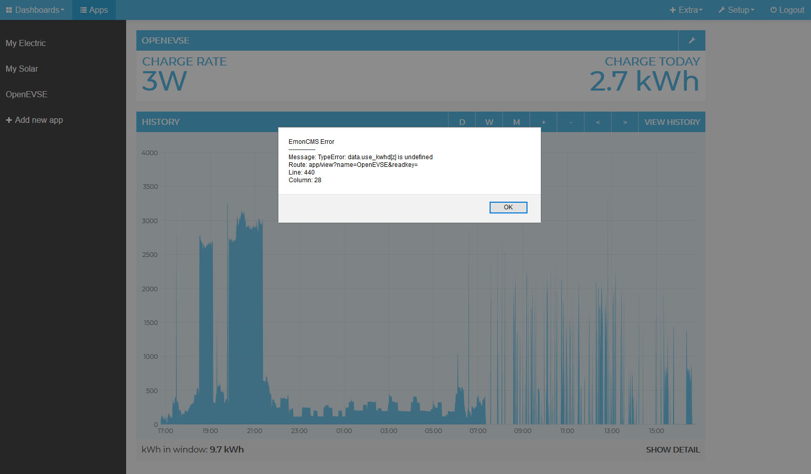

Well progress of sorts. I now have some data appearing on my OpenEVSE page but if the cursor reaches any of the data points this error message pops up. Any suggestions for a fix?

This is the template device/data/OpenEVSE/openevse.json at 2.0.0 · emoncms/device · GitHub you see it has listed feeds like ev_power and ev_energy, hopefully these are the name that the openEVSE app looks for to auto configure.
although it looks like the error message suggests the more generic “use_kwh” feed is undefined. I assume it wasn’t able to “auto-detect” a feed called use_kwh. Whether it is called “use_kwh” or not, you will need phpfina feed that reports your use in kWh’s. If it was named “use_kwh” it will get picked up automatically, otherwise go to the openevse apps config (spanner top right) and use the dropdown for the “use_kwh” feed selection to select the correct feed.
