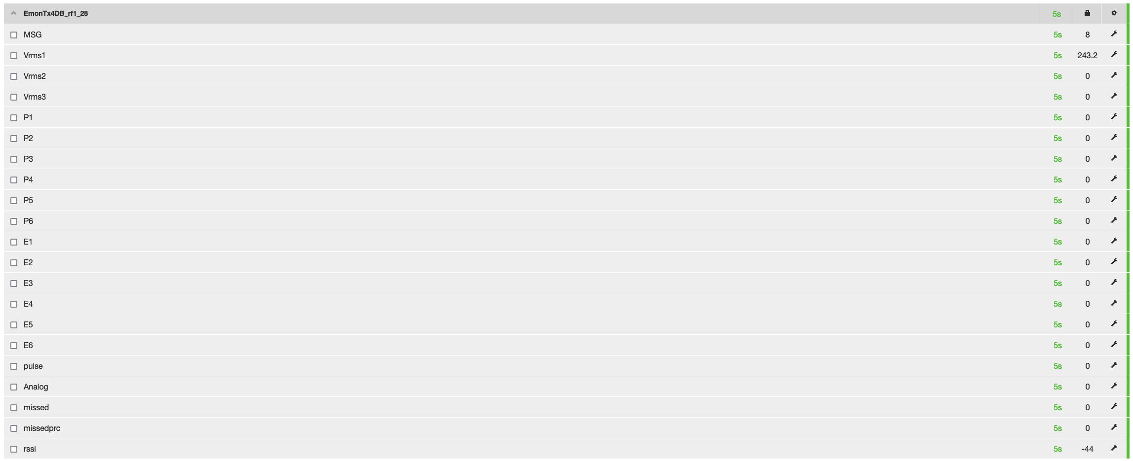

Which then brings me round to the Tx4 which I’d never put into production. It was originally shipped (in June 2023) with the JeeLib firmware, so it needed updating to match the update on the emonPi, but I’ve also put the CT expander in it, before putting it into use.
I intend to use it wirelessly with the emonPi.

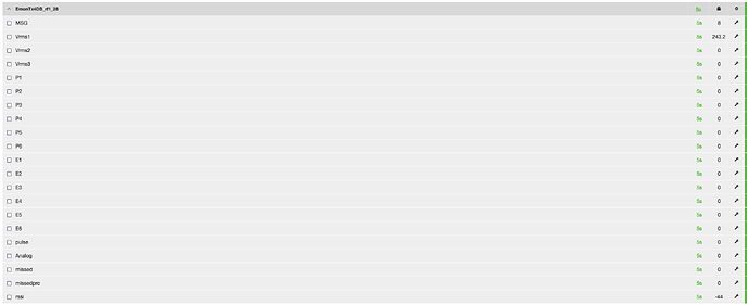

I flashed the relevant firmware (emonTx4_DB_12CT_1phase_LPL), but it doesn’t seem to be found automagically by the emonPi. There’s no red LED flashing/briefly on startup/power plug in on that firmware (there is on the 6CT firmware). I’m not sure if that’s expected, or relevant.
If I flash back to the 6CT firmware, emon_DB_6CT_1phase_27 appears in the inputs automatically, and all seems to be playing nice. Plus the red LED comes on for a few seconds after power on.
6 CT Expansion board — OpenEnergyMonitor 0.0.1 documentation seems to suggest that autoconf should work:
If you have the latest version of emonhub with autoconf enabled, it will automatically populate the node decoder configuration below.
I have tried adding the manual config as it’s mentioned, and then saving, rebooting EmonHub, and even the whole emonPi, to no apparent avail.
I haven’t tried the Tx4 plugged into the emonPi for anything other than firmware yet, so I guess I should do that (though the config change potentially conflicts with the existing config for the monitoring equipment in the emonPi itself), and also see if I can get the serial console as suggested under emonTx4, emonVs & emonBase Install Guide — OpenEnergyMonitor 0.0.1 documentation

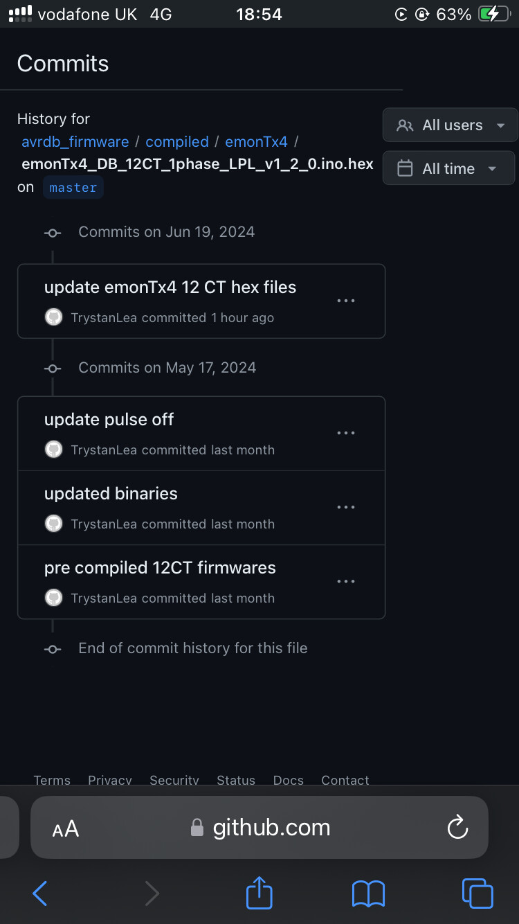

So it kinda seems that my theory that something is wrong with the firmware/the flash, may indeed be the case…
The flash log for the 12CT has some noise (but so does the 6CT), which I don’t know if it is relevant.

It seems the web serial can talk to it ok…
firmware = emon_DB_12CT
version = 1.2.0
hardware = voltage = 1phase
No EEPROM config
vCal = 101.30
iCal1 = 20.00, iLead1 = 3.20
iCal2 = 20.00, iLead2 = 3.20
iCal3 = 20.00, iLead3 = 3.20
iCal4 = 20.00, iLead4 = 3.20
iCal5 = 20.00, iLead5 = 3.20
iCal6 = 20.00, iLead6 = 3.20
iCal7 = 20.00, iLead7 = 3.20
iCal8 = 20.00, iLead8 = 3.20
iCal9 = 20.00, iLead9 = 3.20
iCal10 = 20.00, iLead10 = 3.20
iCal11 = 20.00, iLead11 = 3.20
iCal12 = 20.00, iLead12 = 3.20
pulse = off
RF = on, rfBand = 433 MHz, rfGroup = 210, rfNode = 28, rfPower = 25, rfFormat = datalog = 9.80

I’ve uploaded fixed hex files and tested here, could you try uploading again?
Thanks!
I’ll have another look later tonight when I’m back home and I’ve finished off doing some jobs.
It would be good practice to actually change/increase the version number (or add/increment a suffix) when anything changes (even if just rebuilding the same code, for example under different config or flags. But especially if you’re not embedding a git hash or similar in), as it’s entirely possible that users could be using multiple different versions (in this case, now 4?) that appear to be externally the same version. And it might not be possible to easily differentiate between them…
Yay!
