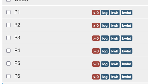

Originally I wondered if this was the problem, that it was trying to talk to two different devices.
It kept autoconfig-ing itself and showing up in the list, so I hard to turn that off, and then still had to enable the “disable further input creation” feature to stop it appearing as inputs…

Unfortunately, it’s still failing after turning it off autodiscovery (at least in emoncms) on the emonHP, but that doesn’t mean the radio still isn’t doing things in the background.

I guess I might aswell try turning autodiscovery back on on the emonHP, enable device creation again, and port over the (limited) feed logic I have on the emonHP… And start pulling that data into HA, and swap over the energy monitoring devices that it’s using.
Moved it over to the emonHP.
