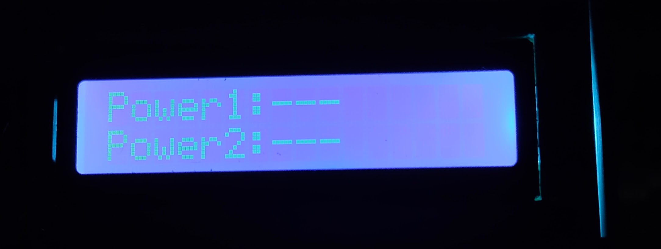

Something caused my emonPI to lock up tonight. The LCD display had frozen, no response to pressing the button and no response to the network.
So I had to power cycle it.
It appears to have come back to life, but I can see one issue.
On cycling through the LCD display, Power1 & Power2 both indicate “—”. However, both of these feeds are reading and logging values which appear to be correct.
Both CTs along with the Voltage Adapter are shown as detected on the LCD Display during the startup.
Would this be a hardware or software issue I’m looking at?
In the event that the unit has a fault, are replacement EmonPI units still available?
At the moment I’m making a backup of what’s there and I do have a backup which was made last week.
Just to add to those. It’s only the Power1 & Power2 values on the LCD which seem to be the problem. All the other data shown on the LCD such as wifi status, vrms, appear to be fine.
Cheers
Mike
How old is the system / SD Card. Most likely it is an SD Card failure.

Hi,
The SD Card is less than a year old, it was replaced back in January this year when the system was showing some corrupted data in the feeds. The emonPI was four years old in August.
I could flash an image onto a spare card to see how that affects the values on the LCD Display.
The emonPI had several reboots last night and the hardware powered off completely to ensure a full reset. The only thing I see is that the Power1 & Power2 values are still indicating “
so, I might leave it till the weekend if it’s still functioning and only the local LCD display values are affected. Is it possible that the power value indications are unrelated to the lockup and that these values on the LCD have been faulty for some time? I don’t visit the electrical cupboard very often to press that button.
But I wouldn’t mind understanding what corruption/failure has taken place to stop only the power values indicated on the display. Should I be looking at any particular log file?
In my mind also, is that the system has grown from only two CTs and a couple of EmonTH’s. To have 245 Inputs, 270 feeds, 10 dashboards and collect/shares feeds and inputs with Home Assistant. It is four years old so I have thought that since the home relies on it so much, I should perhaps consider upgrading to the new version which I see splits off the power monitoring from the database/webserver which means I’m really only looking at a Raspberry PI being the culprit of a Total Failure of the system which to me seems easier to repair.
It is possible you are pushing it a bit, but I’d be surprised if that caused the failure.
Can you access it via SSH?

Hi, yes I can ssh and ftp into the PI. I had a look though almost every logfile I could last night.

Can you post the output (use Ctl-E before posting) from df -h, please?

Thanks, checking it isn’t full logs.
Right now, is everything working apart from the LCD?
Seems to be only two values on the LCD. Looking at the values from the feeds they seem to be reading correctly for the house usage and solar generation today.

But hey, today’s puzzle is these two LCD indications:-)

At startup, the very first message on the LCD comes from the ATMega 328P, because this starts up a lot faster than the Pi. Thereafter, the Pi takes over except when you’ve asked for current and power factor to aid calibration (c command), which come direct from the front end again.
Beyond this, I can’t help you, because I don’t know my way around inside emonHub & emonCMS.
