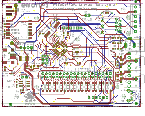

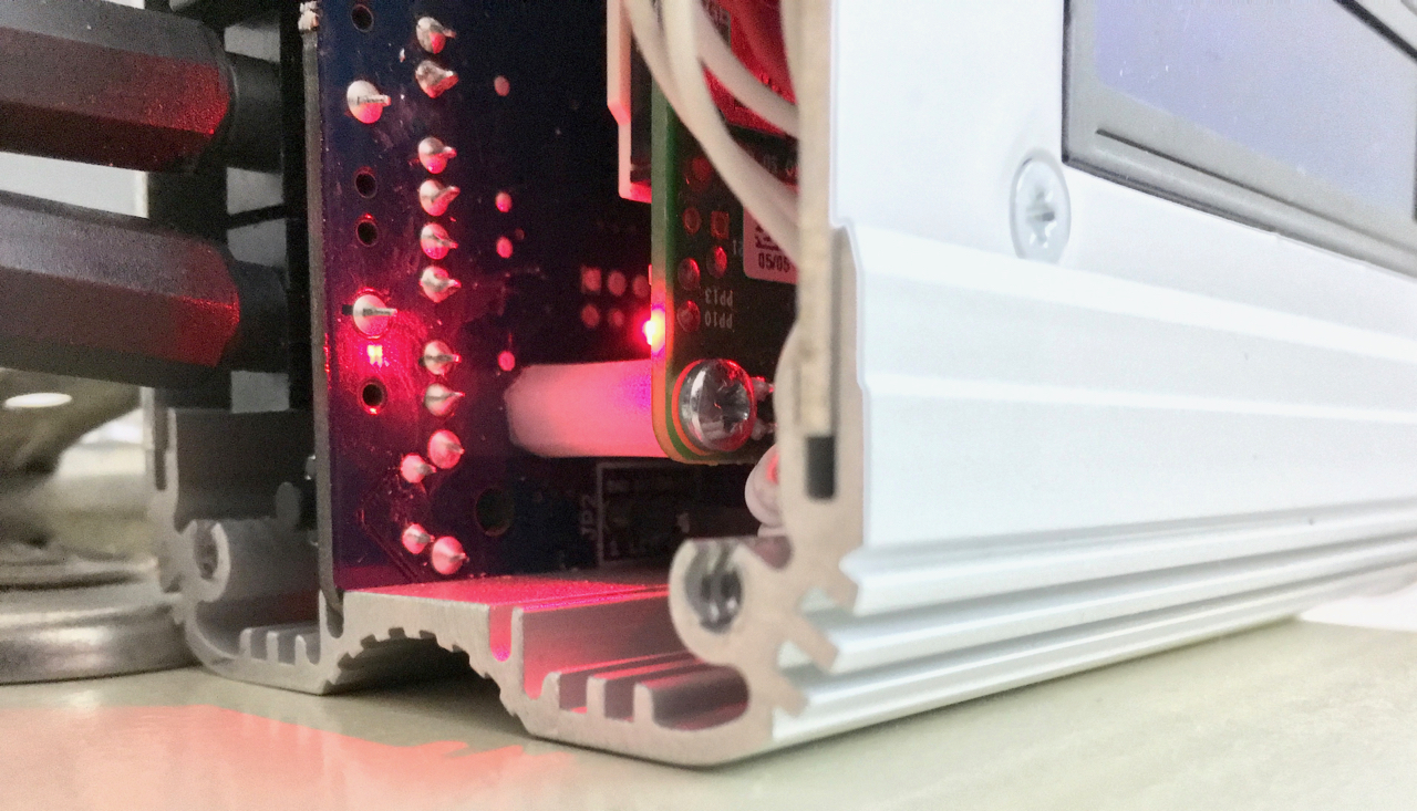

Last year I opened the emonPi case and looked at the PC board, I noticed there are some PCB copper traces too close to the aluminum case. I think there is one trace within the C shaped channel of the case.
In this pic you can see the solder connection almost sits on the case. Keep in mind this is just an example and this particular solder connection may not matter since I think it is a ground.
Next time I take the emonPi apart I’ll locate the trace mentioned above.
I have a July 2015 emonPi and I believe the PCB has changed since then…
EDIT: I found the emonPi board and I added two purple lines that represent how the C channel of the case is close to the traces. This is just eyeballing it (not accurate!).
Strange as it may sound, even if it is a ground, it can still make the electronics go wonky if hit by ESD.
