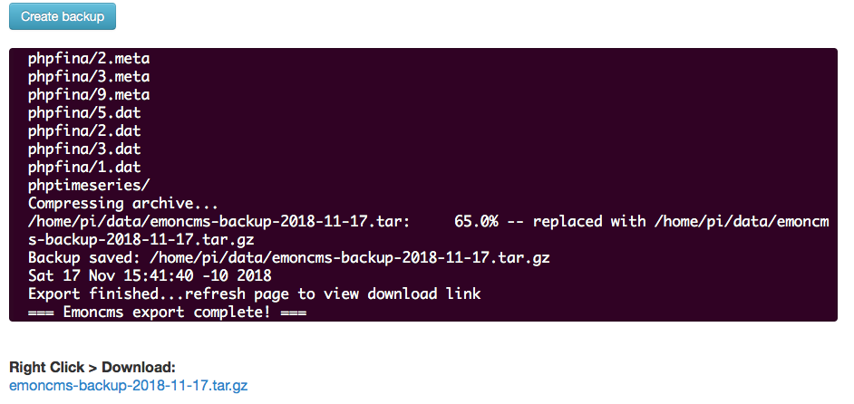

Hello,
Unfortunately I do not still have the orignal image but I can decompress the archive manually using « utilitaire d’archives » standard application on my iMac.
This is what I get.

Good to see that the data is present. Have you tried uploading multiple times? Im not sure what’s going wrong unfortunately. Did you decompress and recompress on your computer?
I tested the decompression command here in isolation on a backup which you could test as a starting point:
cd /home/pi/data/uploads
mkdir test
tar xfzv emoncms-backup-2018-11-16.tar.gz -C test
The error you see is the same as this stackoverflow linux - How to extract filename.tar.gz file - Stack Overflow but the backup archive should be valid for decompression with the command in the importer…

After that, I erased all old files from the uploads directory, created a new backup, downloaded the associated .tar.gz file, and tried to re-import the backup.
Unfortunately, I encountered the same problem.
I noticed that after downloading, the tar.gz file was transformed into a .tar file.
Could this explain the problem?

Great to hear you got it working @Gerard1. To check I understand correctly, the emonpi is offering the backup to download with the .tar extension only?
It seems that the backup generated by emonPi is indeed in .tar.gz but when I download this file on my computer, it appears in .tar only. So I have to use “Keka” to compress the downloaded file in .tar.gz
It may be my operating system (OS El Capitan version 10.11.6 with Safari version 11.1.2) that forces the download in .tar

I do not know the Mac OS, but I think I have read somewhere that it is the Mac OS that “helpfully” decompresses any compressed file automatically.
In this case, it got it wrong.
Computers very rarely make mistakes … they just do as they are told.
Safari has a setting in Preferences → General → Open “safe” files after downloading.
Turn this off and the .tar.gz file won’t be decompressed.
