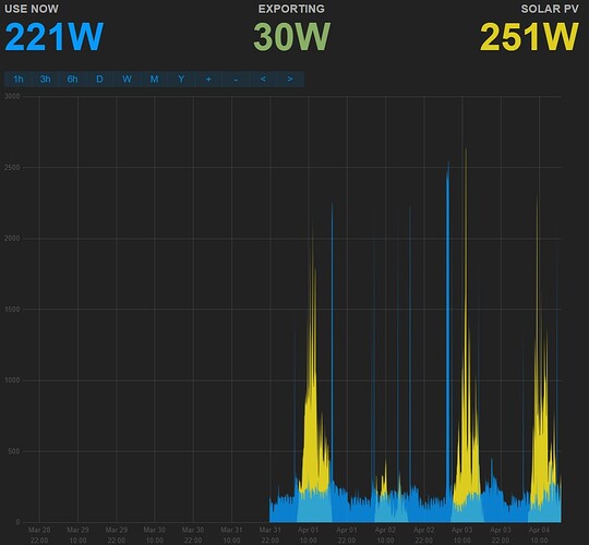

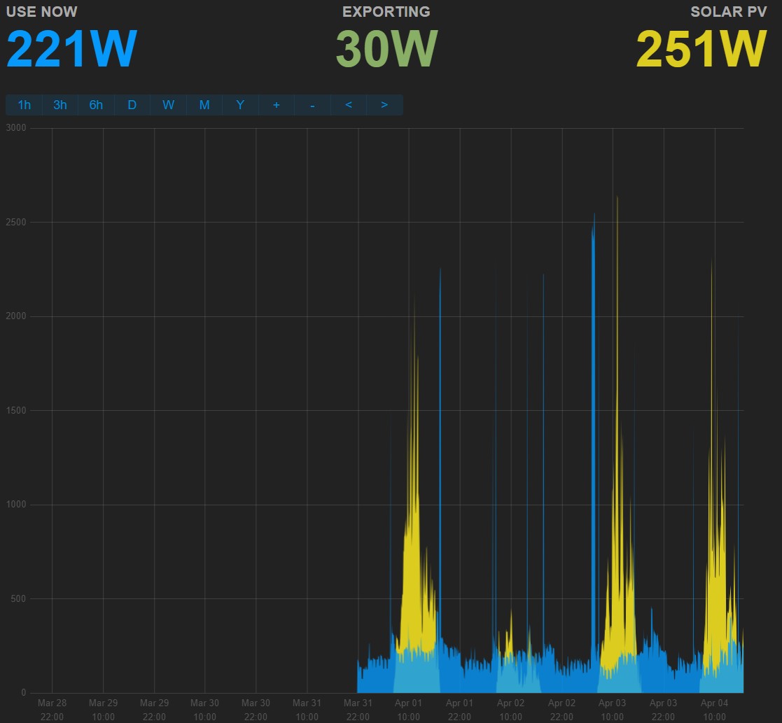

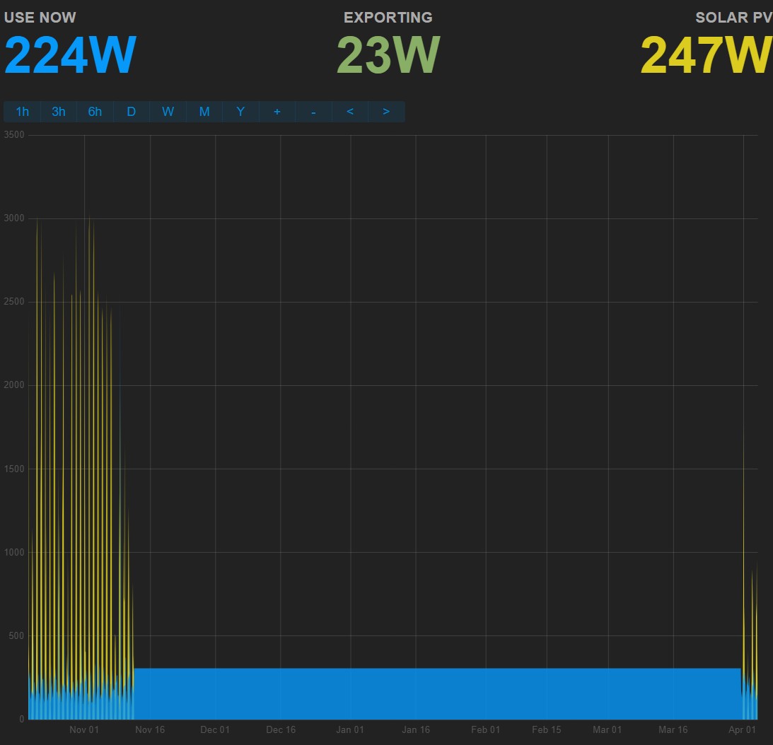

My EmonPi seems to have stopped logging data in mid November last year. It still displays data in real time and for up to six days, but at random intervals between four and six days, the recent data disappears and starts fresh.
This is what occurs now:
The six days prior to this has disappeared.
The Data stopped in November and is blank between then and the current four days:
The data viewer has the same gap in data.
Any thoughts?

I changed the SD card around 12 months ago, because I was still running off the original one from 2016. I don’t recall exactly what SD I used, but it is likely a Sandisk Ultra or similar with 10Nov22 flash. It had been working fine until last November. I do not recall if I performed an update at that time, but I have done a couple since in case that would fix the issue.
The data displayed above ‘disappeared’ again two days ago. I noticed that the system “up time” exactly matched the new data window. I don’t know how the system works but it seems the data is not being appended to the long term data file. Could it be held in a volitile buffer or swap file and then lost when the system restarts? The system restarting less than weekly is also new to me. I recall having system up time of hundreds of days in the past.

After hoping that doing more updates may fix this problem, I had no inputs for a couple of weeks. The culprit was the contiuous monitoring flash. I don’t know why this doesn’t work, but reverting to the jeelib flash fixed this. I have since confirmed that any reboot will result in lost recent data and only new data from the point of reboot. I suspect I did an update on 12 Nov (last date where data is retained) and now the CMS is writing to a different database file. Can anyone give me an idea on where to look?
