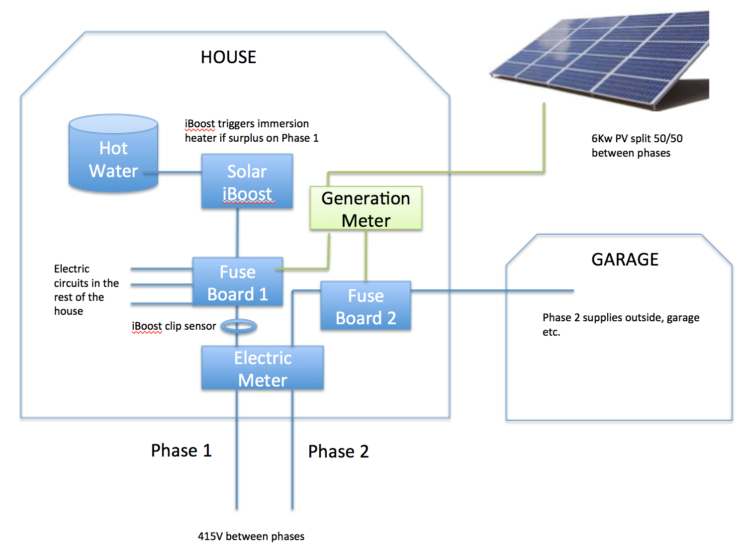

I have a fairly unusual home electric setup due to our rural location with:
  • a two phase supply (2 x single 100A phases split between the internal and external electrical items)
  • a 6Kw Solar PV array split 50/50 between the 2 phases
  • a Solar iBoost driving our hot water immersion if we are net exporting electric on phase 1
My requirements are simply to be able to see if we’re net exporting or importing on each phase (ignoring the iBoost) individually so I can proactively switch items off or on to make use of the PV generation.
I’ve tried a few different solutions and currently have a Geo Chorus II installed and a Lightwave RF energy monitor. The Geo uses the LED on the electric and generation meter so that’s only telling me my aggregated usage and generation for the whole property - not per phase which doesn’t help me actively plan. Note also our Solar iBoost has to be factored in as that skews net import/export when its on if it detects net export.

You say you have two phases - you appear to be in the UK, do you really mean two phases or two feeds off the same phase? (The test is, do you measure 0 V line-line across the two supplies, or 415 V?)
I think a single line diagram showing how and where everything connects would be helpful.
On the face of it, it looks as if you need an emonPi plus an emonTx, because the Pi has only one voltage and two current inputs (ignoring pulses, which you say don’t tell you what you want to know).

The attached drawing shows my understanding. You’re correct I’m in the UK and I know we have 415V between phases - which is why the installation is designed to segregate uses of the two phases to minimize someone experiencing 415V.
How would the emonCMS handle the Solar iBoost - given that is essentially misrepresenting the situation given the phase 1 flow may look almost 0 net export when in fact the solar iBoost is eating say 100W and therefore I could use that 100W elsewhere?

So my first assumption was correct, to read real power (hence the direction of power flow), you probably need an emonPi plus an emonTx, one on one phase and one on the other. Each will monitor its own phase voltage with an ac adapter. Then you have two current inputs on the Pi and 4 on the emonTx, so it looks to me as if the Pi should go on the garage phase with one CT on the grid connection, the second on the PV infeed but on the supply side of the generation meter. You do the emonTx similarly on the house phase. In each case one CT will give the nett grid power flow on that phase (and you add the two in emonCMS in the Pi to give total nett grid power) and the other two CTs give you the respective generated powers, which you can similarly add to give the total generated power.
The emonTx still has 2 spare current inputs that you can use to add detail should you wish. Obviously you can put one of those on the immersion feed so that you know exactly what the iBoost is doing, which will tell you when you can manually divert that extra load. In effect, excess power available is the nett export on that phase plus the immersion load, if I understand correctly.
(Note in principle you can put the CTs anywhere and do the sums appropriately in emonCMS, but I feel it’s safer (more accurate) to measure a small value and add it to a larger one than to measure two nearly equal large values and rely on the difference being accurate.)
