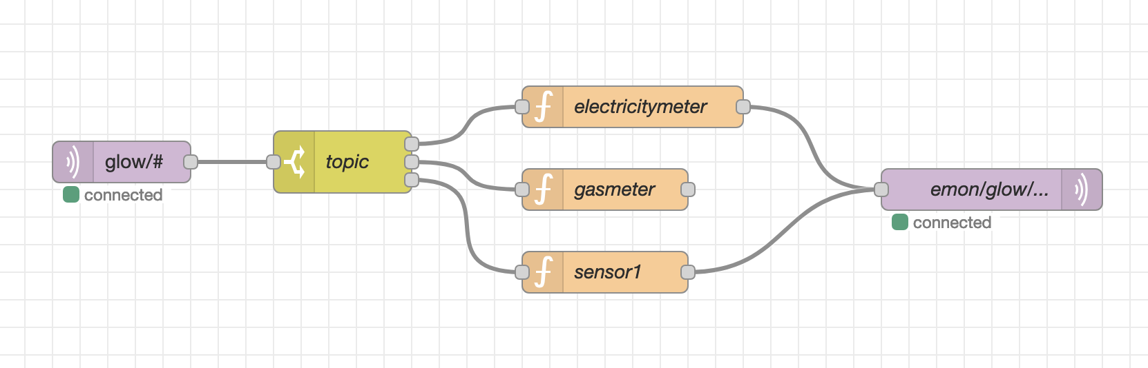

Hello,
I got a Glow Smart Meter in home display (IHD) / consumer access device (CAD) for Christmas and have successfully got it sending data via MQTT to my Raspberry Pi running EmonCMS + EmonHub.
Has anyone else got it importing Smart Meter data into EmonCMS using a emonHub Interface?
I could process it / convert it into the EmonCMS format using Node-RED but it would be nice if it could be done within the emonHub.
Here is an example of the data I receive:
glow/F008D1ECXXXX/STATE {"timestamp":"2025-01-05T12:08:20Z","software":"v1.9.1","hardware":"GLOW-IHD-01-1v4-SMETS2","wifistamac":"F008D1ECXXXX","smetsversion":"SMETS2","eui":"70:B3:D5:21:E0:00:XX:XX","zigbee":"1.2.5","han":{"rssi":-61,"status":"joined","lqi":156}}
glow/F008D1ECXXXX/SENSOR/electricitymeter {"electricitymeter":{"timestamp":"2025-01-05T12:08:16Z","energy":{"export":{"cumulative":0.000,"units":"kWh"},"import":{"cumulative":11883.578,"day":27.935,"week":300.759,"month":241.806,"units":"kWh","mpan":"XXXX","supplier":"Octopus Energy","price":{"unitrate":0.28790,"standingcharge":0.47950}}},"power":{"value":1.019,"units":"kW"}}}
Thanks!

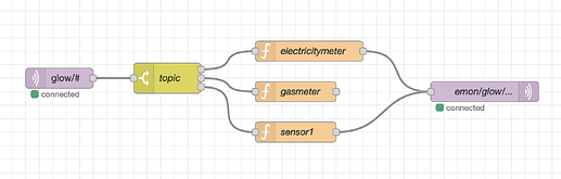

I did get it working using Node-RED:
It reads from the messages sent by the Glow IHD under glow/..., transforms it to the emonCMS simple format and then writes it to a topic under emon/glow/.... It is working well but I am still considering write and emonHub Interface that does this. Would be nice if it all happened on the Pi that all the emonCMS stuff is running on.
